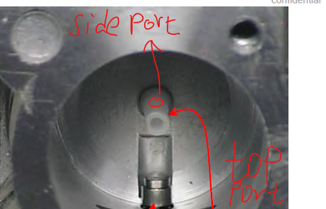

2: when inspect white plastic fuel discharge tube, there is top port, but I also found a side port in the middle section of plastic fuel. It is hard to take photo’s I just draw a red circle from your PDF for demonstration. So is there a side port from your memory? Please see photo uploaded.

I never noticed the small port but best guess is that it is supposed to be there. When you pull the negative pressure with the primer bulb, after 3-4 pumps, stop and say one-one-thousand and the needle should hold at least that long. If it holds longer great, but if it starts bleeding off before you say one-one-thousand then you have a slow internal leak, probably the low speed check valve which will not effect running, just how well it primes. If this engine has a lot of run time it may not be the carb, it could be a leaking seal on the crank, which will make it hard to tune, and maybe you get it to tune today but tomorrow it runs crappy again, or just runs erratic. I forgot I have a worksheet that goes with the tutorial, see attached. Do you know how to do a pressure vac test on the crankcase? The other thing that can cause an issue is how you adjust the carb.

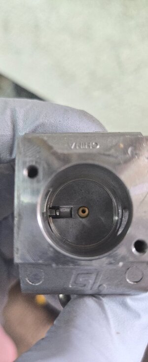

4: As per service manual for L screw initial setting: 1.5 anticlockwise turn from seated and H screw initial setting: 1.25 anticlockwise turn from seated. Engine only start when LA screw all the way in and L screw is on fully close position to 0.25 (1/4) opening position. Thus, I was not able to a do lean drop off tuning on my FS94, but have done before on few Stihl 2 stroke engine with tachometer, video refer to your lean drop off tuning description: https://www.youtube.com/watch?v=UyngDl_2km0

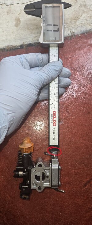

5: how deep the H screw suppose to be in? I just measure with digital caliper measure from top of the screw to the top metal flash, around 1.7-1.8mm, will it be too deep or can go deeper? manual stated to be seated, I feel like can go more further to 2.0mm, but doesn't want to damage the H screw, see photo in red circle

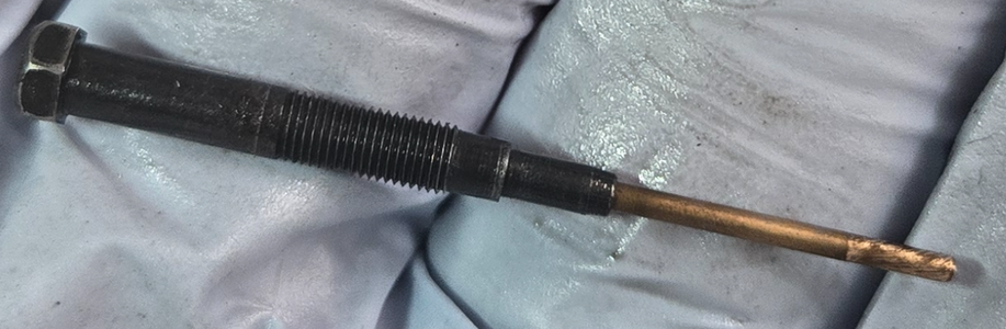

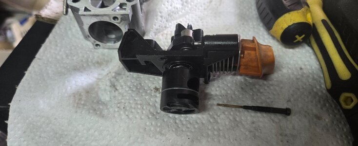

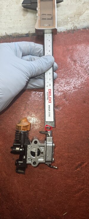

Hi, EFSM, see photo of my RC2 rotary with oring on the barrel , white plastic fuel, L screw. L screw seems has minor scratch at the end, but it is metal and it is only contact with white plastic fuel tube, no idea where scratches come from.

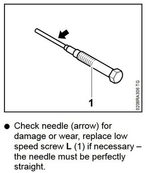

That is your problem. Replace that needle and you will have your adjustment working again. It is an extremely soft metal (brass alloy) instead of the stainless steel needles that Walbro uses, which never wear out.
Ok, thanks, going to order a L screw needle

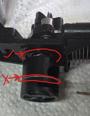

And is the thin oring fit it correctly on the barrel?

The o-ring needs to be slid up above the rotor into a little groove if it’s like the normal Zama RB carbs
Thank you for your reply. When I initially took of the rotor found the oring was sitting on the above the rotor in the little grove, then look at the manual, though it was misplaced. Now thank you for the new insight, I just reattach new photo, does it sound correct?
