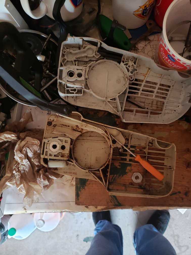

Working on Stihl 201 TC. Inboard clutch so chain brake in clutch cover. Problem is brake Spring comes off when releasing the brake. Any suggestions will be much appreciated.

Pics?

I dug out 020T to compare. Missing cover over spring. I replaced the burnt covers behind the clutch and overlooked this cover part.
