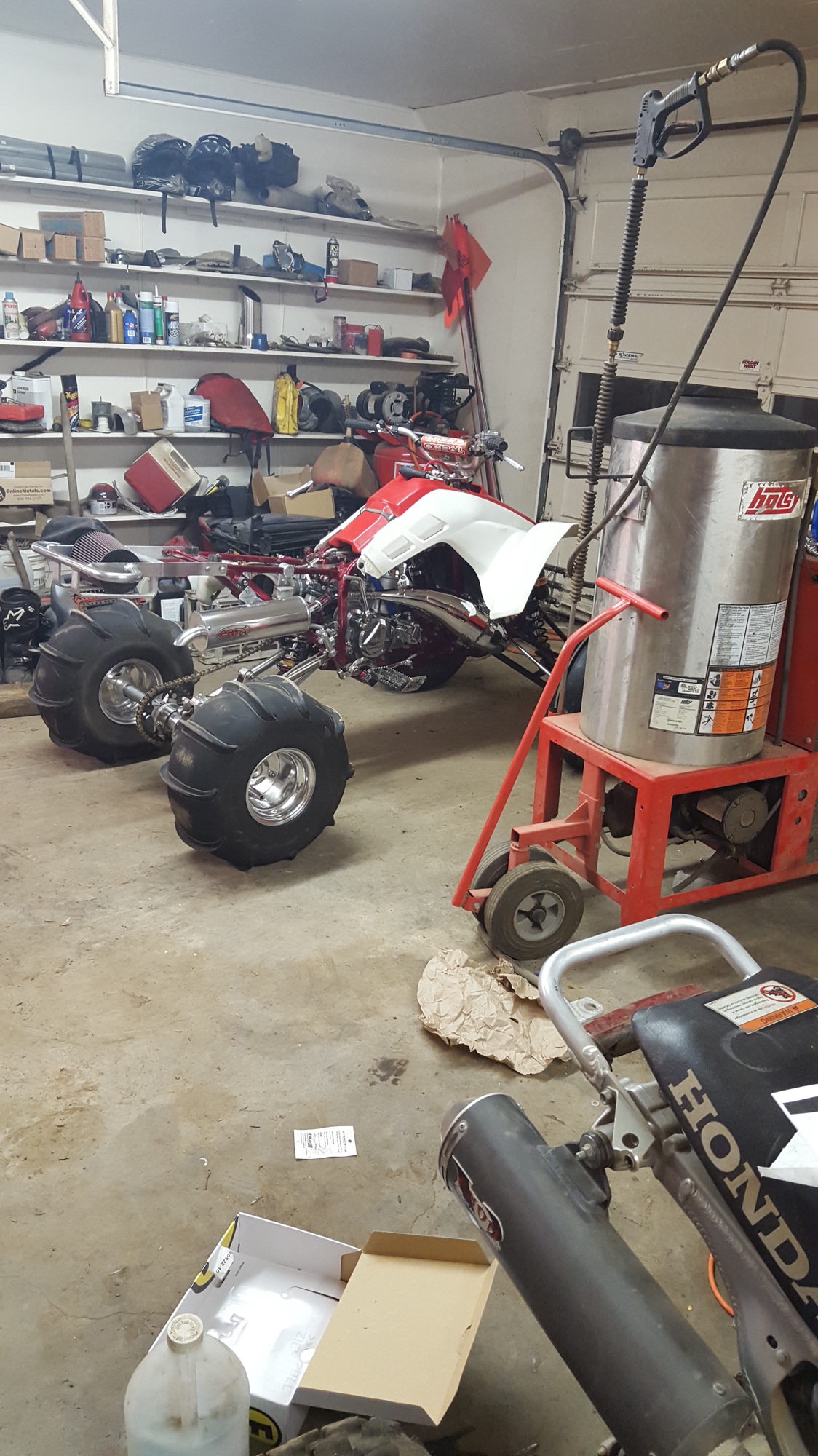

My garage is full with customers bikes, Hoping to have one out of here today! So I can start building out the frame. Got my 1-1/8 bar clamps on with some old bars for mock up, and couldn’t resist putting the plastic on frontView attachment 165984View attachment 165983 View attachment 165982
