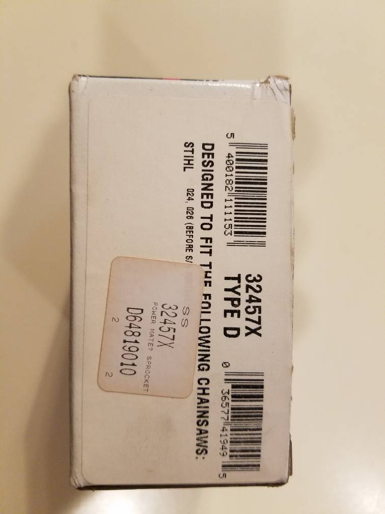

I took a pic of the Oregon sprocket and rim. And a Stihl micro rim.
This box part number is for the old style fixed oiler 026s.
