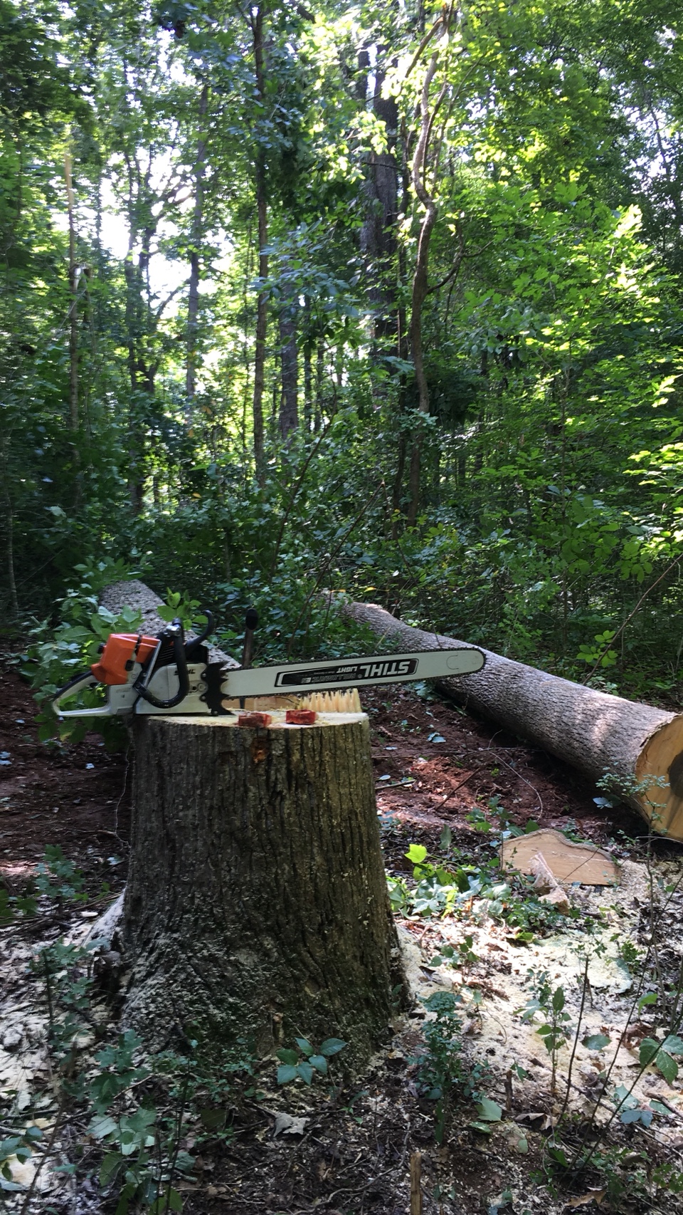

Has that saw seen wood besides when it's sitting on it? Lol. Just funnin! They look good as chit with that wrap handle.
You need to learn how OPE works my friend...thread responses include a picture of the saw in question with a heartfelt story about the model and why you should keep it.
If you need any help never be afraid to reach out to sawmikaze..im always on location and just a fone call away.
Appreciate the offer, but check the quote above my post it contains all the details.
