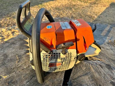

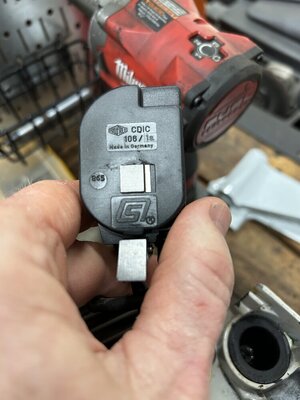

Working on an 064; seems to fairly unmolested. Didn't get the # off the flywheel when I had it off, but it does have a single keyway. Pic of the coil is below. Serial number on the saw is 123965831. Has a Bing carb.
Is this an unlimited coil? If not, it's governed, right? At what rpm?
Thanks,
Scott

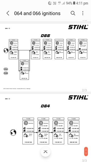

Scott -
You have the 1122 400 1303 coil. It's a CDIC coil, commonly referred to as the "shoebox" coil because of its' shape.
I believe they're governed at 12.5k. They're usually matched with flywheel 1122 400 1204. The 1204 flywheels came with
either single or dual keyways. Here's @Definitive Dave 's 064/066 ignition/flywheel thread on AS:

Thanks, Jacob. I'll check out DD's thread.
Scott
