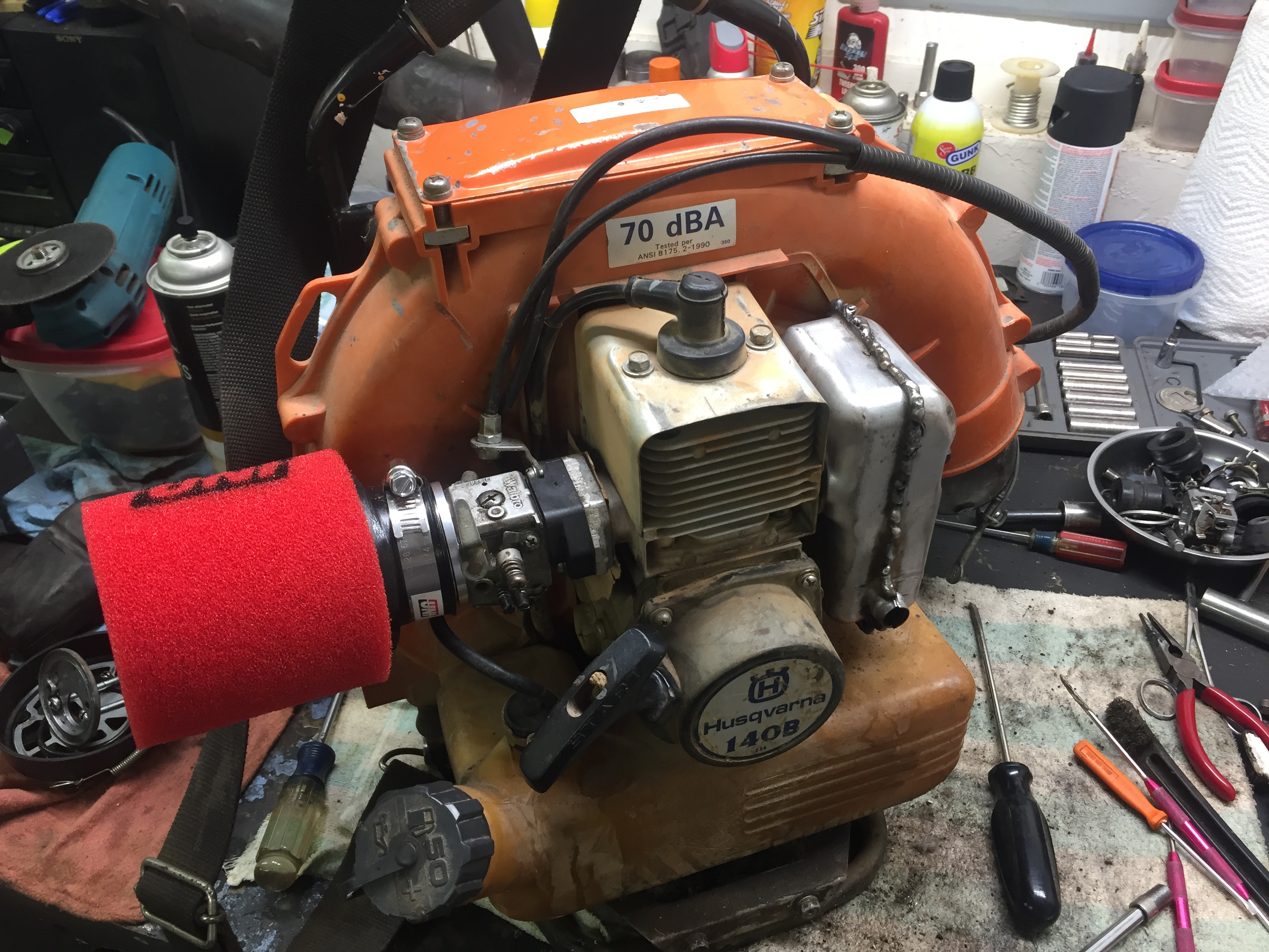

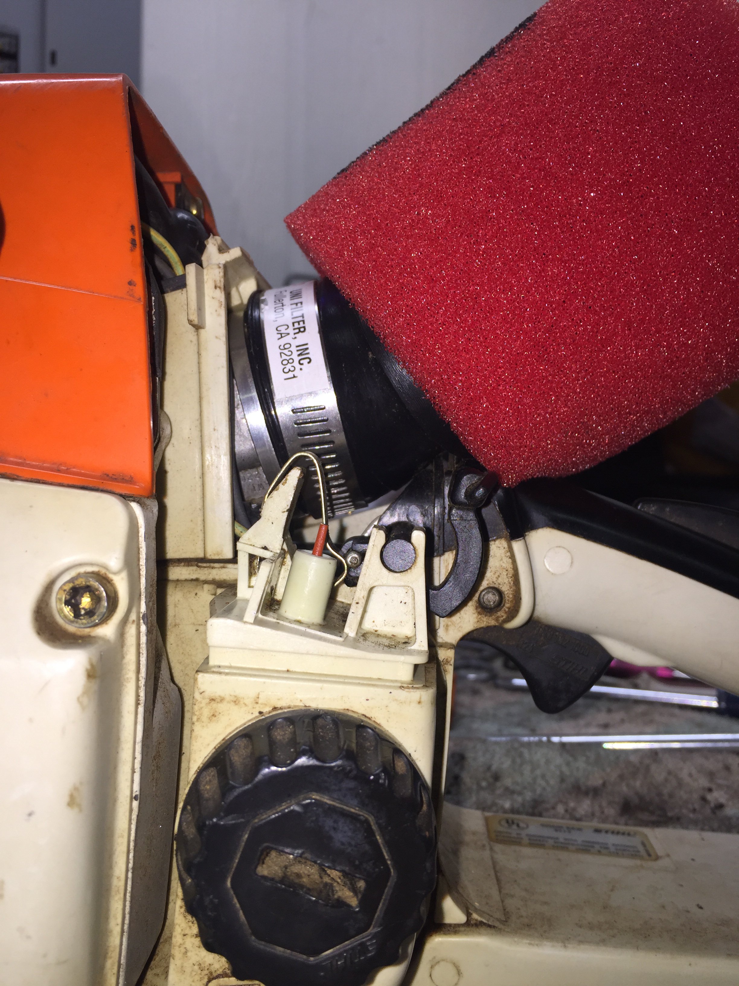

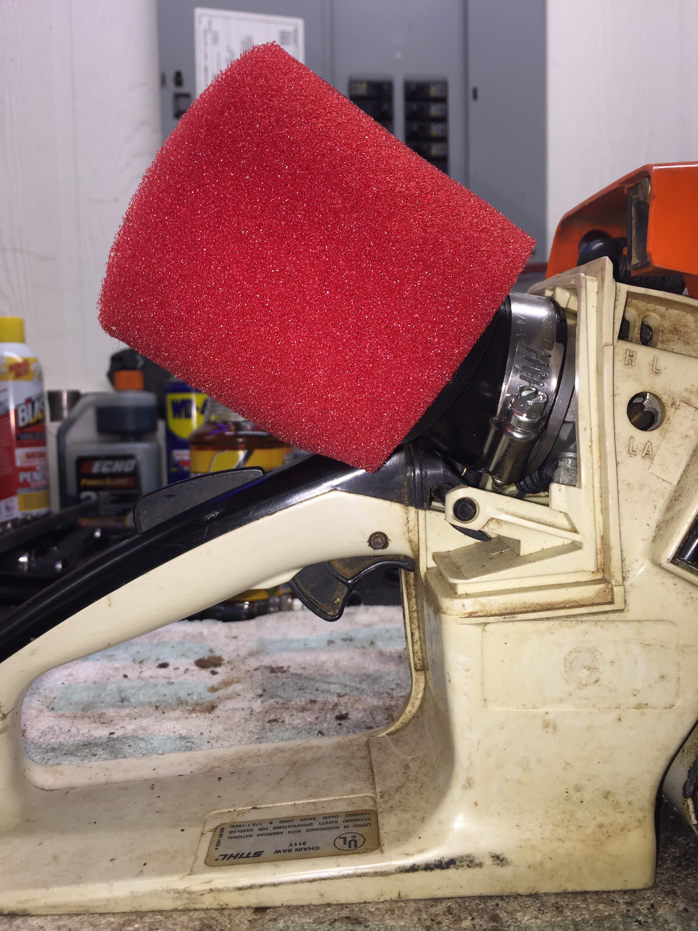

Bought one of these. Had to waller out the bolt holes ever slightly. Fit like a glove.
https://rover.ebay.com/rover/0/0/0?mpre=https://www.ebay.com/ulk/itm/232692070418
And one of these. Could use a bit more angle on the dangle. It’s sorta in the way to pull the go trigger.
I’ll get pics on a saw tomorrow. Here’s one on a blower I’ve been playing with.

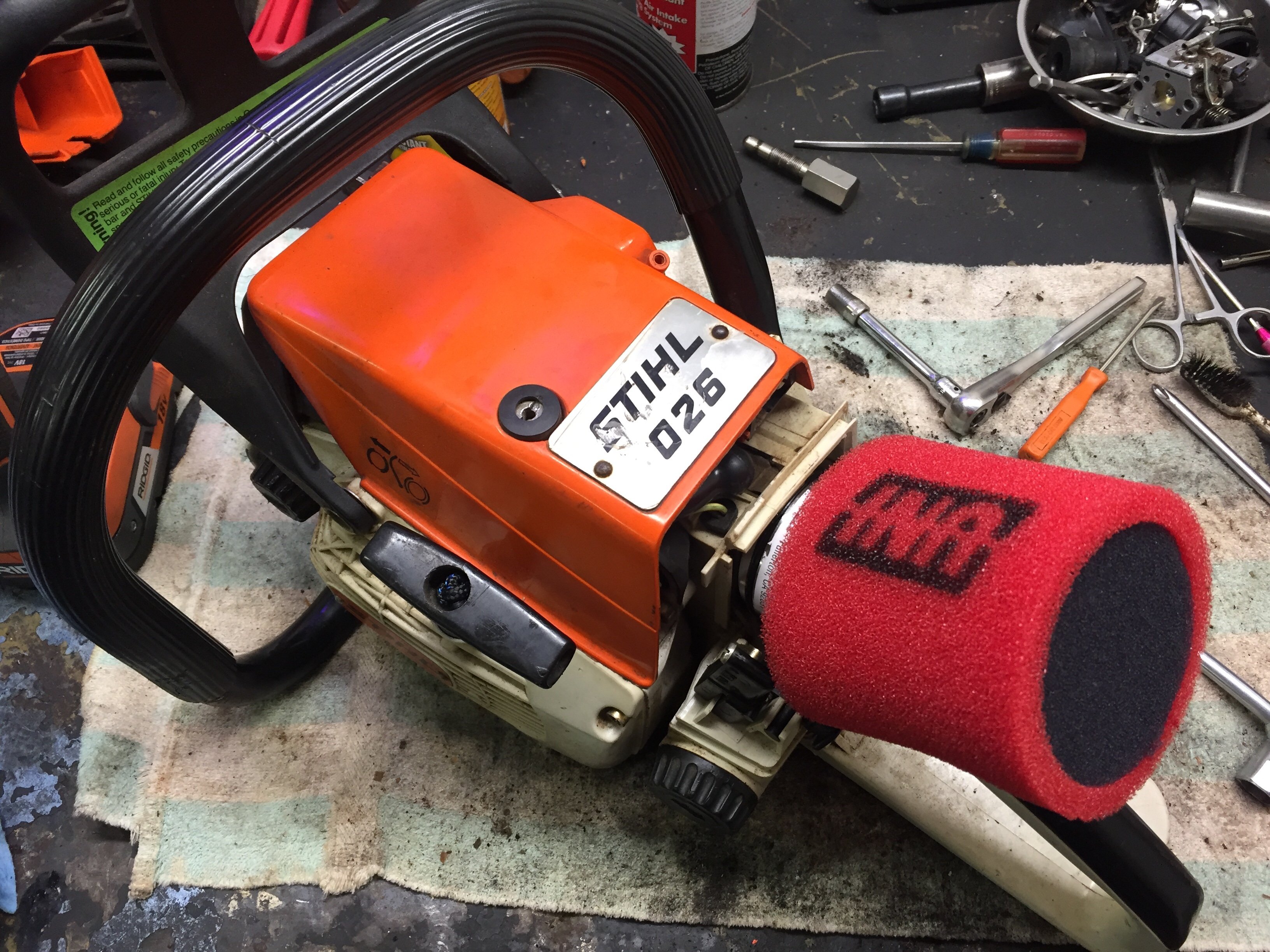

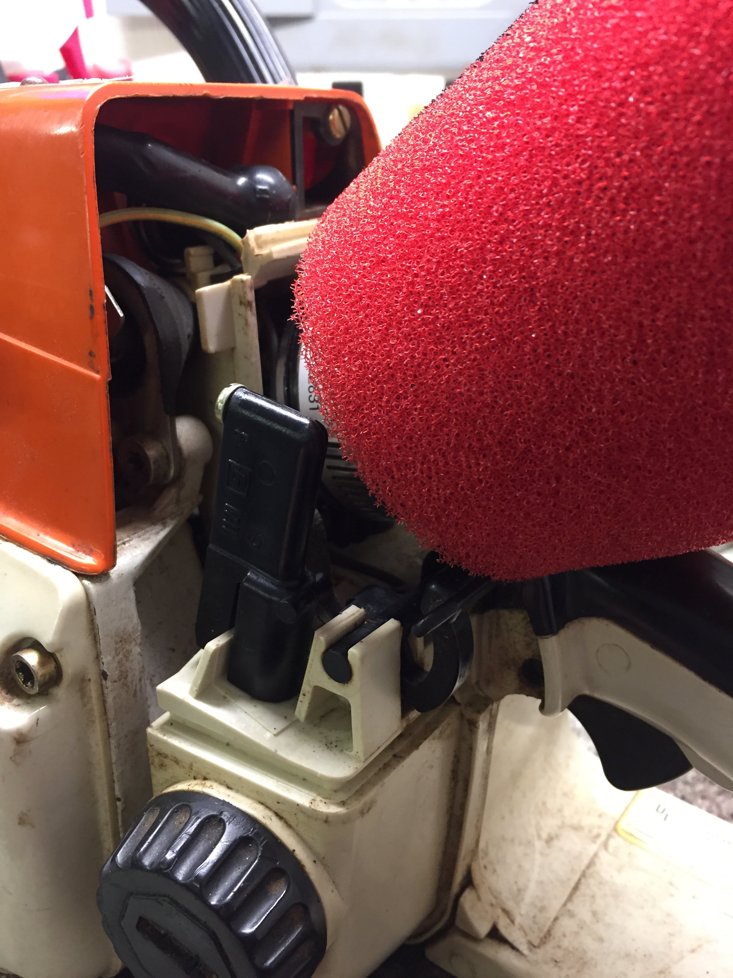

Okay, here we are 2 months later. I have managed to find/fabricate all the parts for installation of a velocity stack and foam filter on my 026 MOFO. The V-stack is from DDM Racing ( something with RC cars ), the filter from UNI with an angle of 15 degrees, the rear cover is an original Stihl part I have modified and finally the 45 degree angle.......designed by me and a friend and 3D printed in ABS plastic. Everything fits
nicely on the 026. Have not tested the saw yet. View attachment 212309
View attachment 212307 View attachment 212308
