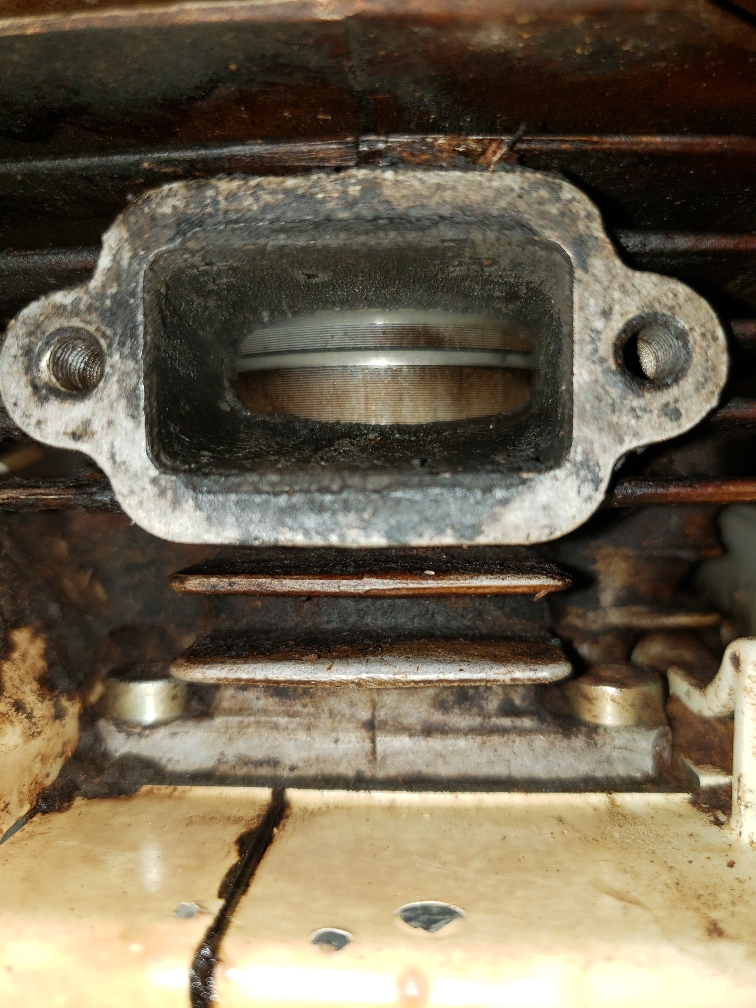

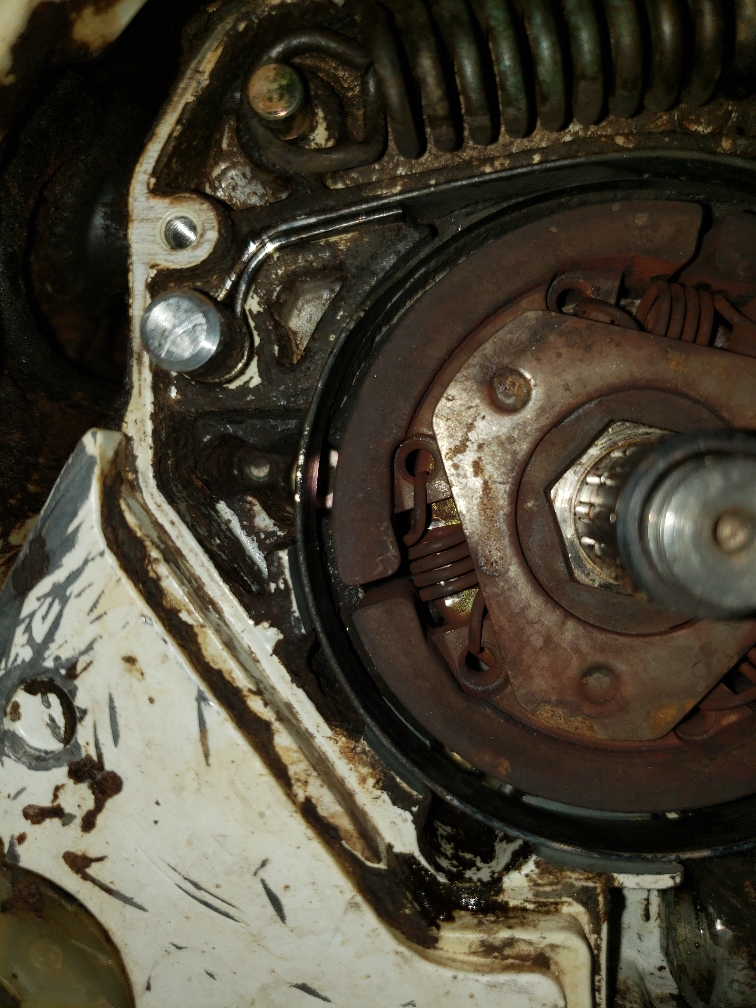

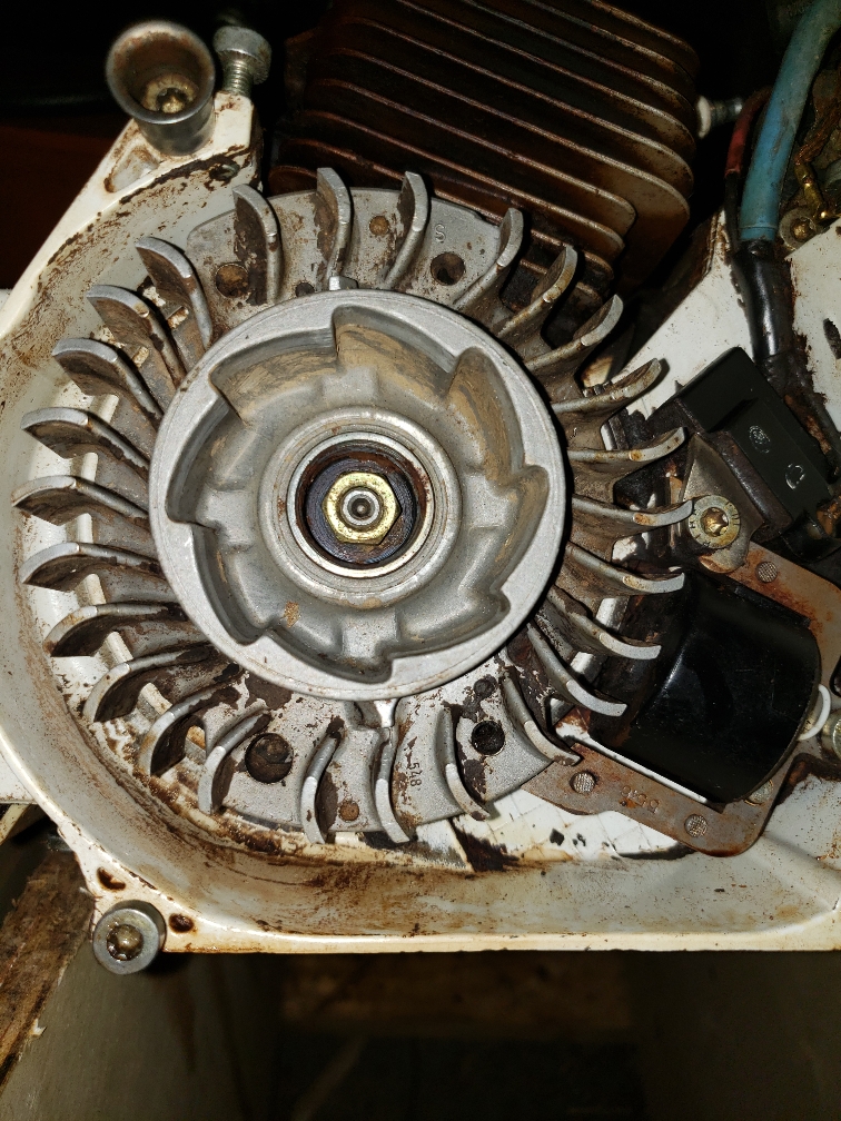

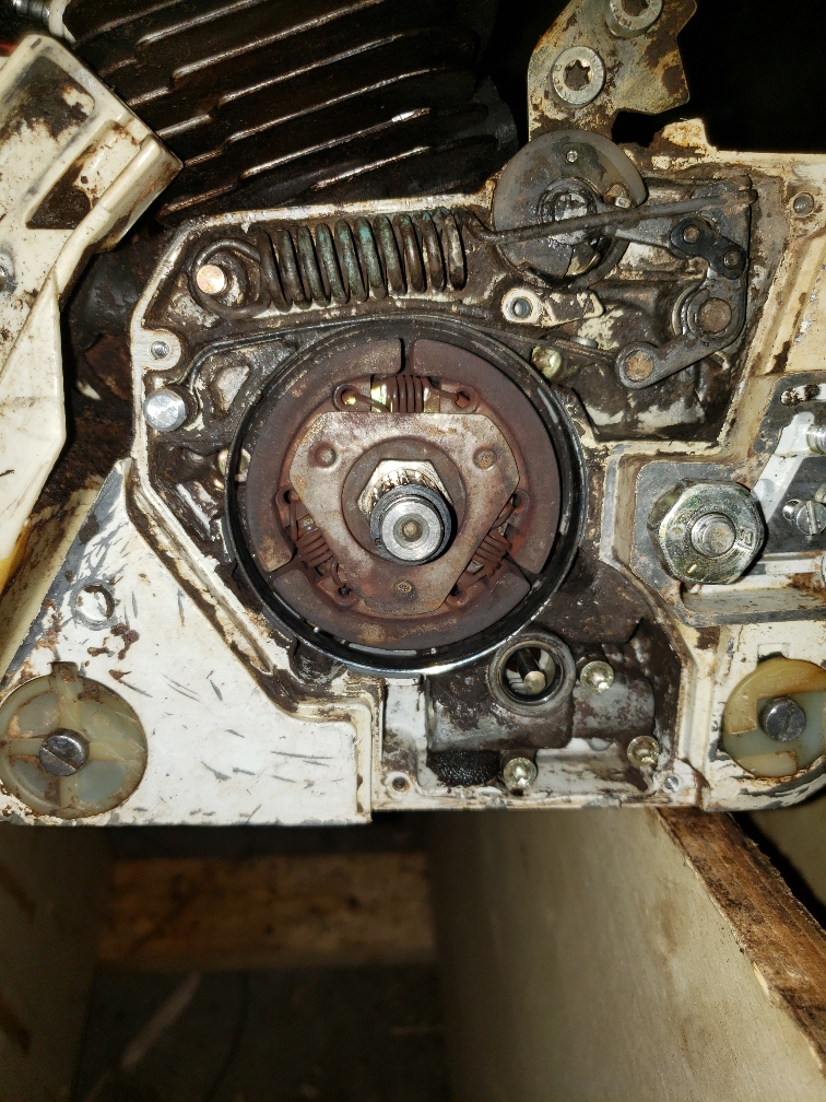

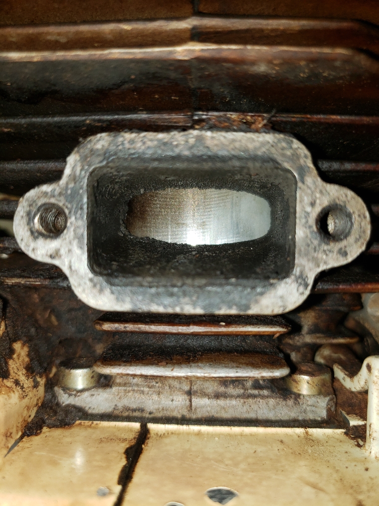

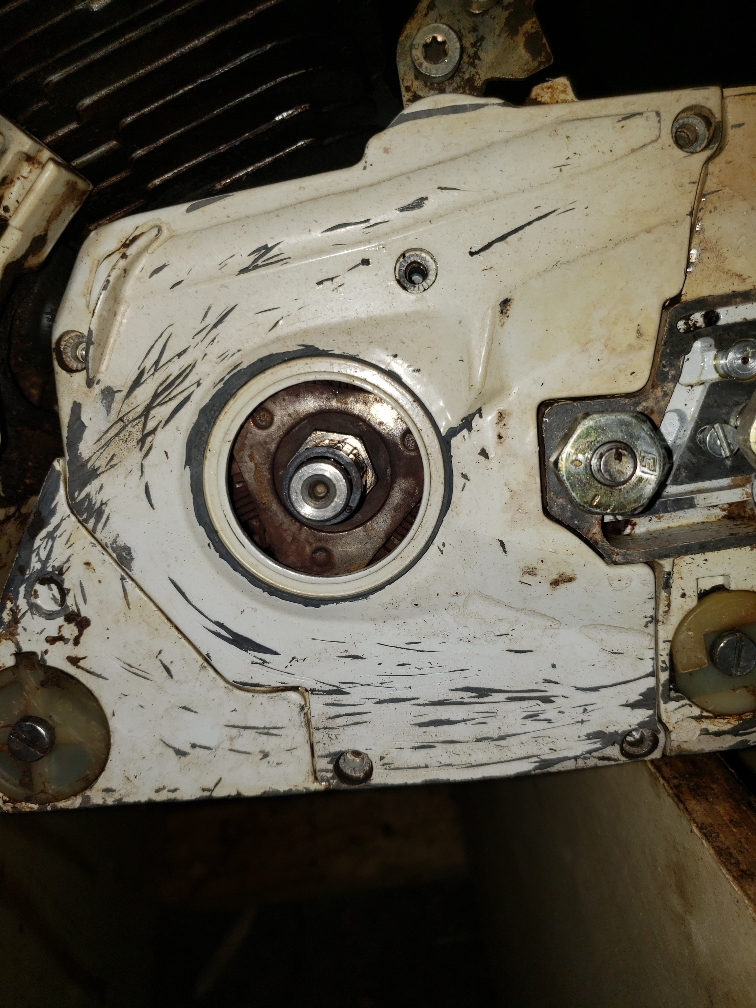

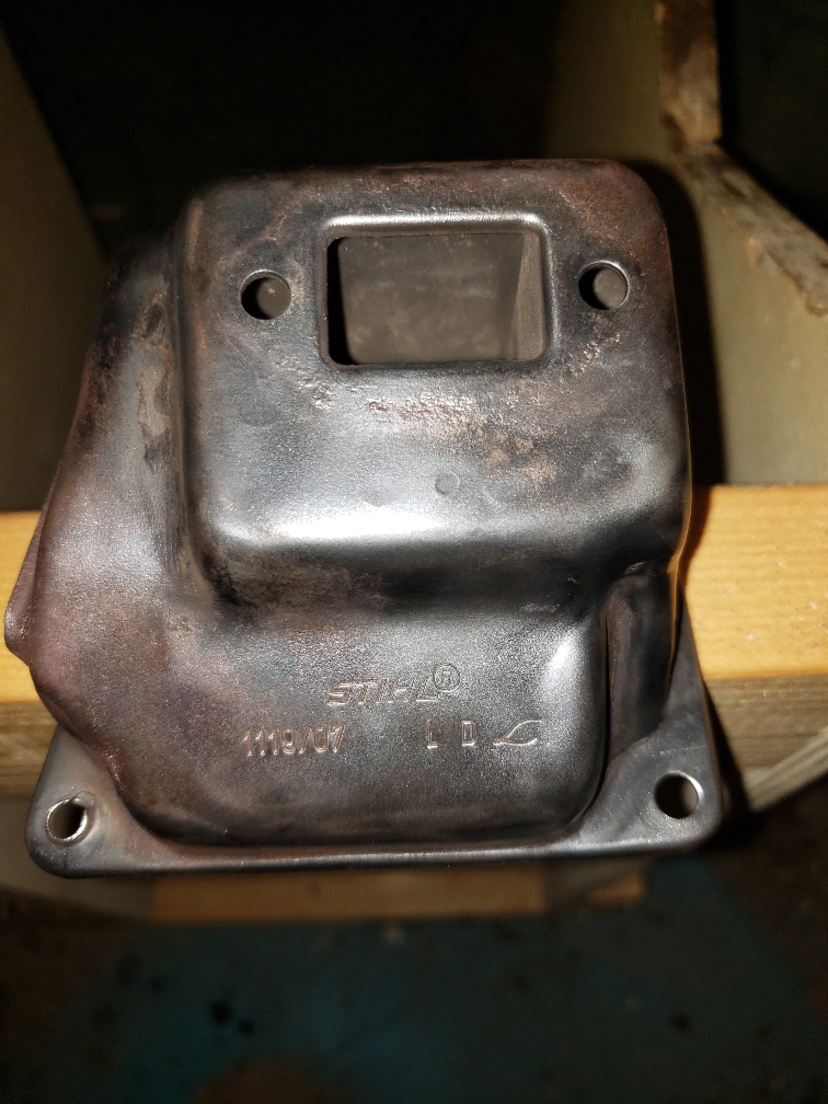

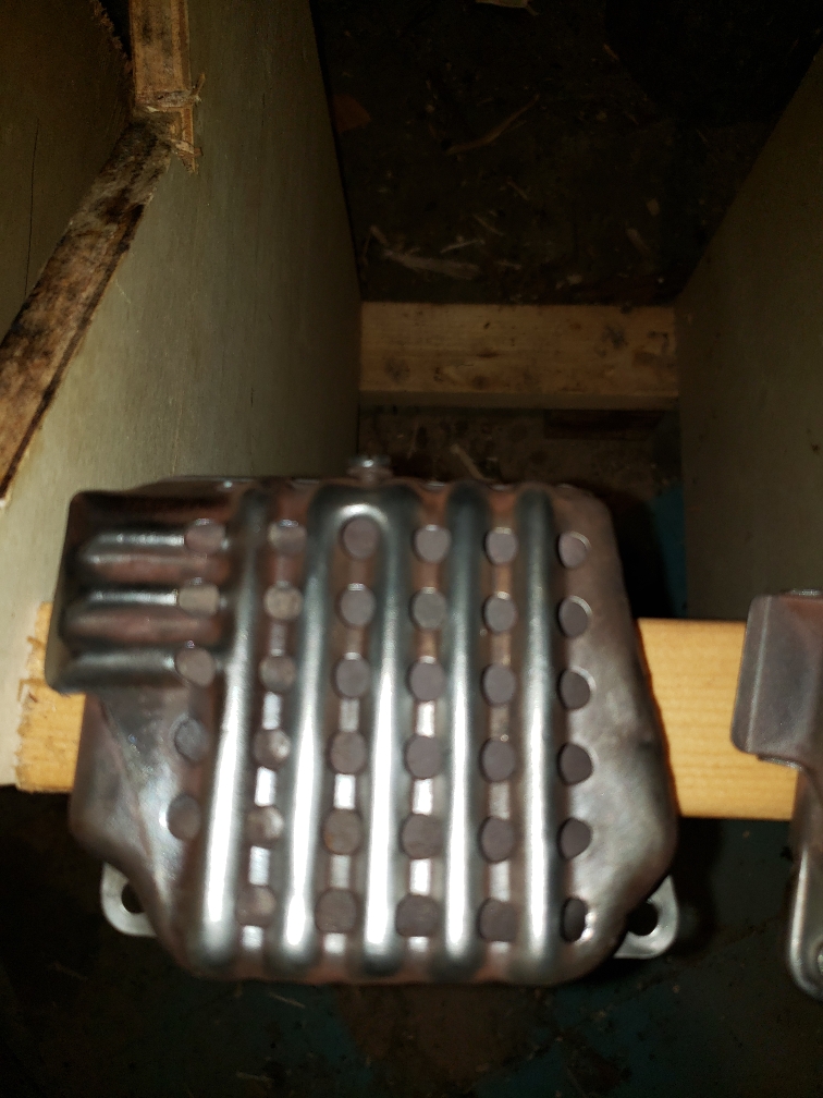

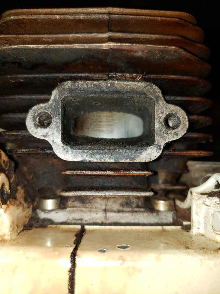

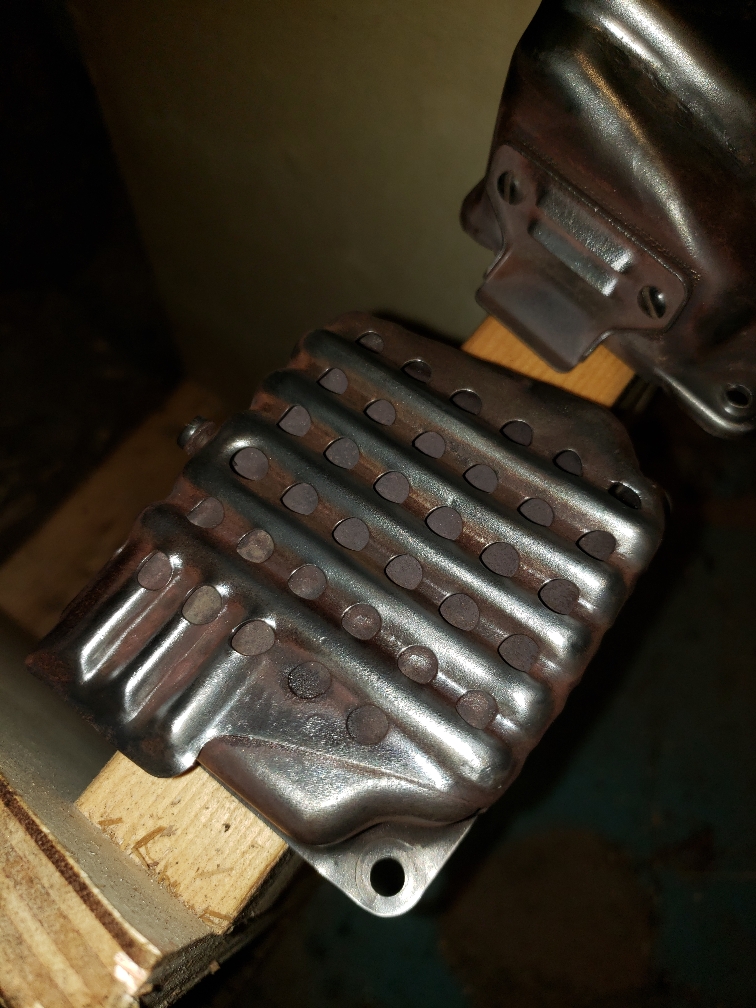

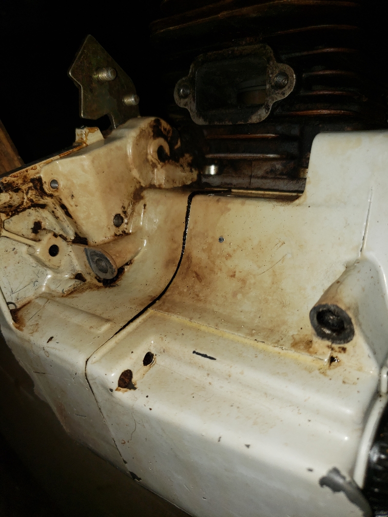

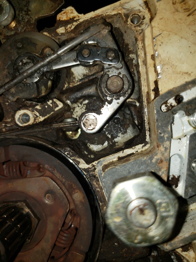

More cleaning. Theres all sorts of crud cooked in all the nooks and crannies inside of this saw. Clutch cover looks like it had chain contact at one time...probably had one let loose. The piston looks pretty good from what I can see of it. Rings look good too.
I cleaned the muffler and got the crud off the outside of it. Cleaned the screens too. What to use to paint the muffler with? Any suggestions? Just to keep it from rusting out.
