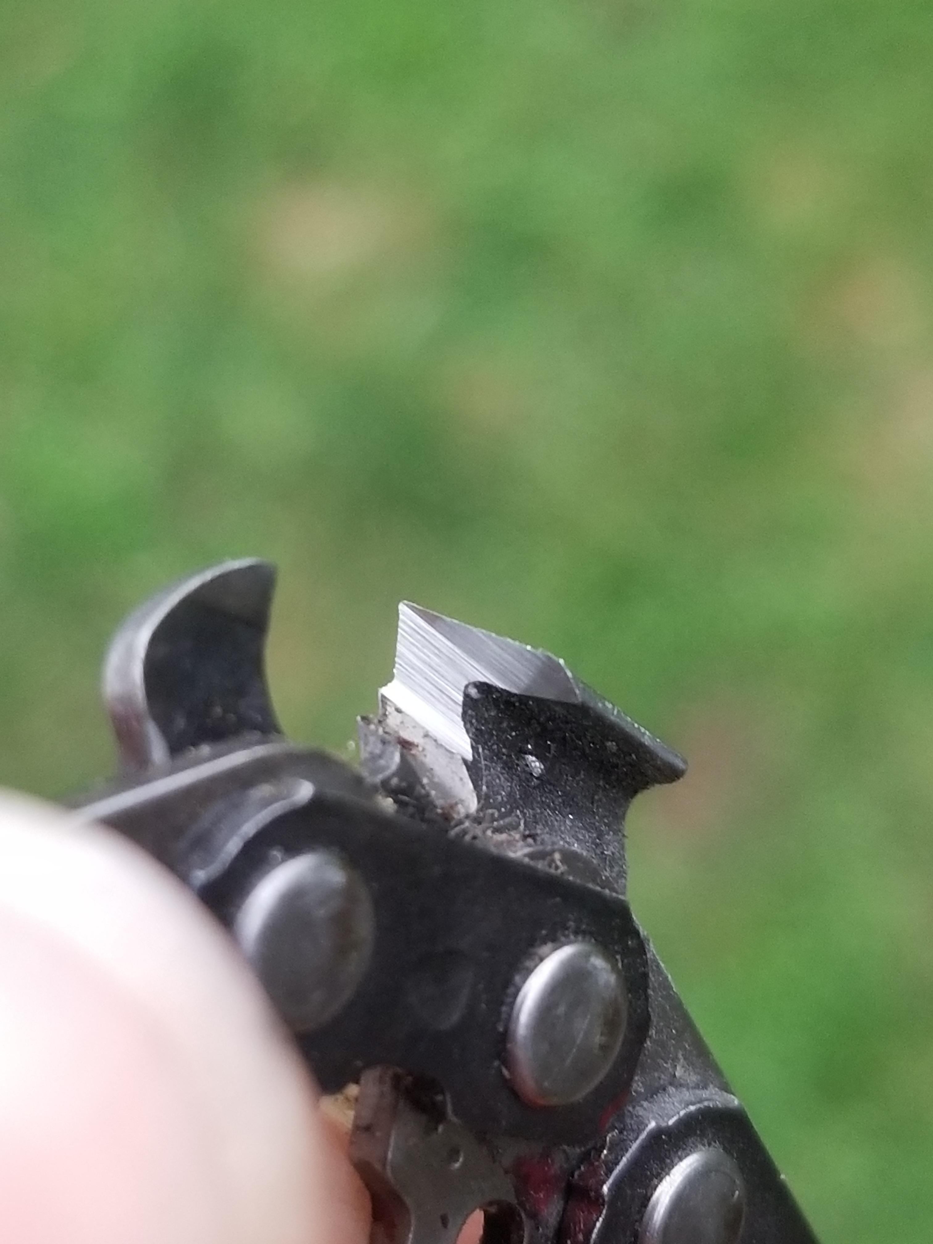

63PS55 is full chisel yellow non safety chain. Thats what you want! To make it even better do this to it!
This is the best thing you can do to the full chisel on a pole saw or 200T for hardwood removals. That said tread lightly on limbs if your saw is modified. The round ground Raisman with the bumper link and full chisel cutter is softer but fine to use on 50 - 55 dl 050 bars in wet or green softwood. I use the bumper link 50 dl 0.043 on the pole saw only with a mini single rivet tip bar. The 200T will trash the single rivet bar tip in short order. Use the Stihl or the Total 14" on those in 0.050 is best imo. You can run the 16" but let it sing and make it square filled. Easiest chain to convert imo.
Ground saws get semi chisel in dirty wood.
