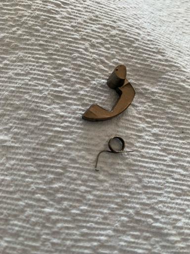

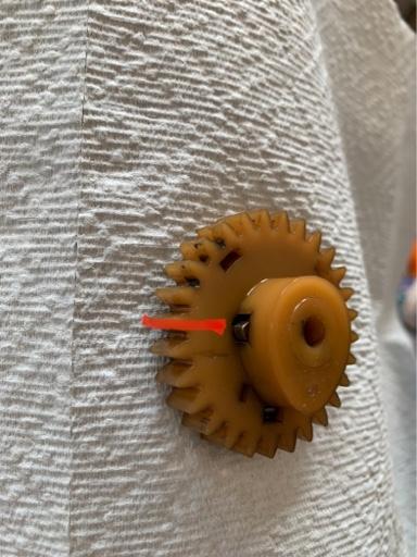

I finally got some cooler weather and mostly time to tear into this engine. The main issue found was that the exhaust valve was crusted with hard carbon and leaking like a sieve. The exhaust passages behind the valve and to the muffler were also caked in fairly soft carbon. The inside of the engine was also covered in plenty of mix oil. I suspect that this accumulated due to poor running after the exhaust valve started to leak. The inside of the engine and valve train was covered in soft black carbon and oil that will wash away with fuel mix. Other than this the engine looks almost brand new inside.
Unfortunately, the root cause is still unknown. At this point I am speculating that the engine and cam gear got hot and caused the decomp cam to get stuck and allow carbon from the poor combustion to get hammered into the valve seat. @67L36Driver does this look like your sticking decomp cam results?
I am sort of loathe to remove the decomp cam as it will put excessive strain on the recoil assembly and rope.

Clean it up, lap the valves and then put it back together. Set the valves at .010 MM. Make sure to use new crank seals. The very next thing to do is see how and what oil they're mixing in the gas and be sure they're using 89 octane only. A high quality synthetic oil mixed at no fatter than 50:1 is required. I use Amsoil mixed at 80:1 in nothing but name brand gas and I have zero problems with any of my Stihl tools, both 2 strokes and 4 Mixes.
Gaston
8:16 PM
11290
Dec 24, 2019
162
331
Oregon
In my experience, I take the valves and clean all the carbon off with a wire wheel. Then lap them good. I have seen piston rings wear and have pretty excessive gap. Make sure you check the crank bearings and the large end rod bearing. Have seen a couple with large rod bearing failure making for a noisy engine and varying compression readings.
