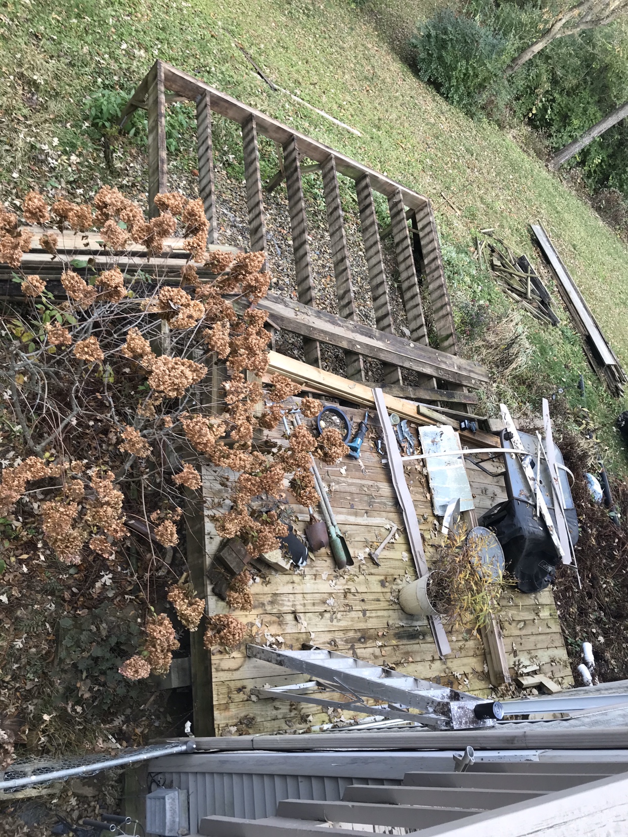

Ok so the title says it all... I figured you all would have opinions...???
I have a bunch of used green treat that I need to store outside for 1-3 years... maybe more... we all know how projects get sidelined. Anyhow I have a bunch of 2x12 and 2x6 green treat from my deck and want to save it for projects to be named later. So the questions are...
1.) Do I sticker old wet green treat to let it dry?
2.) Do I want to band it together?
Both deck levels had 2x6 top boards (upper deck top already replaced) and the lower deck is getting demo’ed and replaced with a paver area for fire pit.. both levels are 14x14 approximately. So lots of good old green treat thats not today’s fast growth wood that rots immediately...
