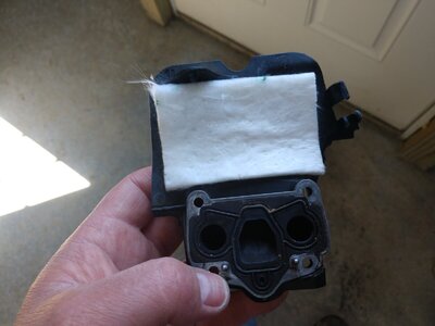

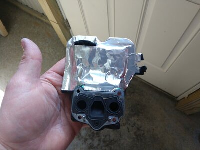

Try adding some foil tape to the partition and maybe a muffler mod. Look up 562xp mods. Sounds like it's heat soaking. Here's one I did recently and it seems like it's working well. Thin piece of aerogel insulation covered with foil tape. I realize it's not the same saw but the basic principles should apply..
