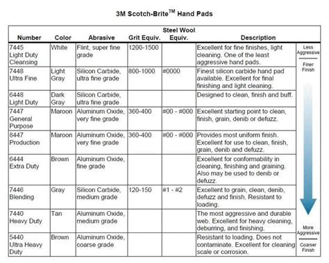

I use the green. Only ones I could buy

I don’t see green on this chart but the green I’ve used is in between the fine grey and the maroon/red.

After my eyes bleeding from every search engine turning up nothing. All I have is some text ripped from a place called Ballreveiw.com.
SCOTCHBRITE GRIT CHART (courtesy of Charlest) back to top
3M Scotch Brite Nylon Pads:
7445 - White pad, called Light Duty Cleansing - (1000) 1200-1500 grit
7448 - Light Grey, called Ultra Fine Hand - (600-800) 800 grit.
6448 - Green (?), called Light Duty Hand Pad - (600) 600 grit
7447 - Maroon pad, called General Purpose Hand - (320-400) 320 grit
6444 - Brown pad, called Extra Duty Hand - (280-320) 240 grit
7446 - Dark Grey pad, called Blending Pad (180-220) 150 grit
7440 - Tan pad, called Heavy Duty Hand Pad - (120-150) 60(?)
Green Scotch Brite is available EVERYWHERE. It's 600 grit.
Blue Scotch-Brite is considered to be about 1000 grit.
(The value inside the parentheses is directly from 3M.)
3M Chart
Less Aggressive --------> More Aggressive
7445 7448 6448 7447 6444 7446 7440
Finer Finish --------> Coarser Finish
I couldn't find it on 3M's website. Go figure. But. Here it is.
