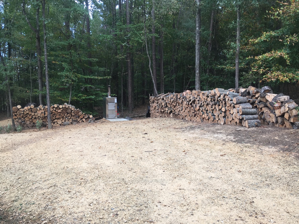

I have a hardy h2 and love it. For my house and situation a OWB is the only way I would choose to heat with wood. If I had a smaller different design house I would consider a stove. I love the mess staying outside along with any danger associated with fire. I bought this particular unit new last year and installed it for about $8000. I did all the work myself except for the HVAC tie in. I have endless DHW and 160 degree air at the register all from burning deadfall from the farm. It saves me about $600 a year in propane and about $1800 in electricity. Not a bad payback on the initial investment. I've seen some really good used OWBs and some really bad ones just have to make sure what your getting.
