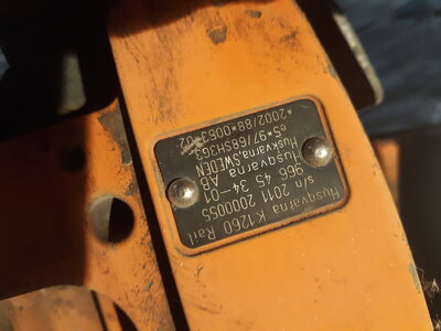

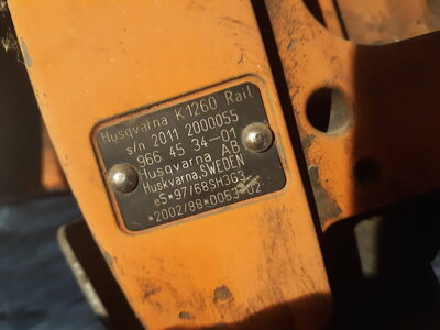

I was gifted a straight gassed K1260. What I have found out is it is a 119cc engine. Are parts compatible with a 3120?20240121_152439.jpg

Same cylinder as a 3120xp.
If you pull the cylinder, can you measure the height and width and the bolt pattern for me?

Some parts are the same/similar: crankshaft, cylinder/piston, clutch, carburetor, muffler, various fasteners and smalls.
The crankcase is not the same and very difficult to convert into a chainsaw. Intake tract is not the same either and the air filter
system is quite a bit different.
