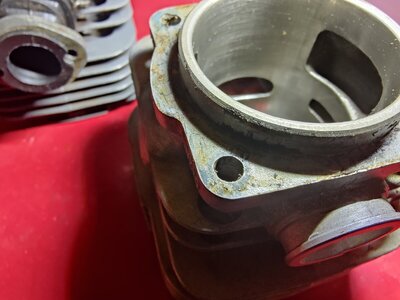

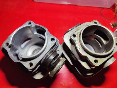

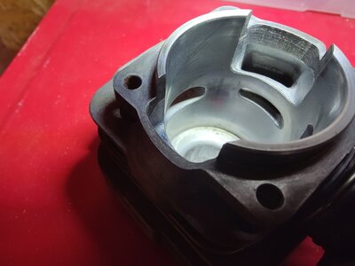

Here's a pic of both cylinders, and each one separately showing the relationship between the transfer port and exhaust port.

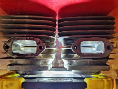

Here a pic of the cylinders with a ring pushed in with a piston, rotated 180 to keep perspective. the bottom edge of the rings are positioned at the opening edge of the transfers. The measurements between both cylinders are idenitcal. So the area from the top of the exhaust ports to the bottom side of the rings is all that is open when fuel begins to come in. It's less than halfway.

Just from photos the transfer upper to exhaust height looks pretty normal. I would run it before grinding anything.
