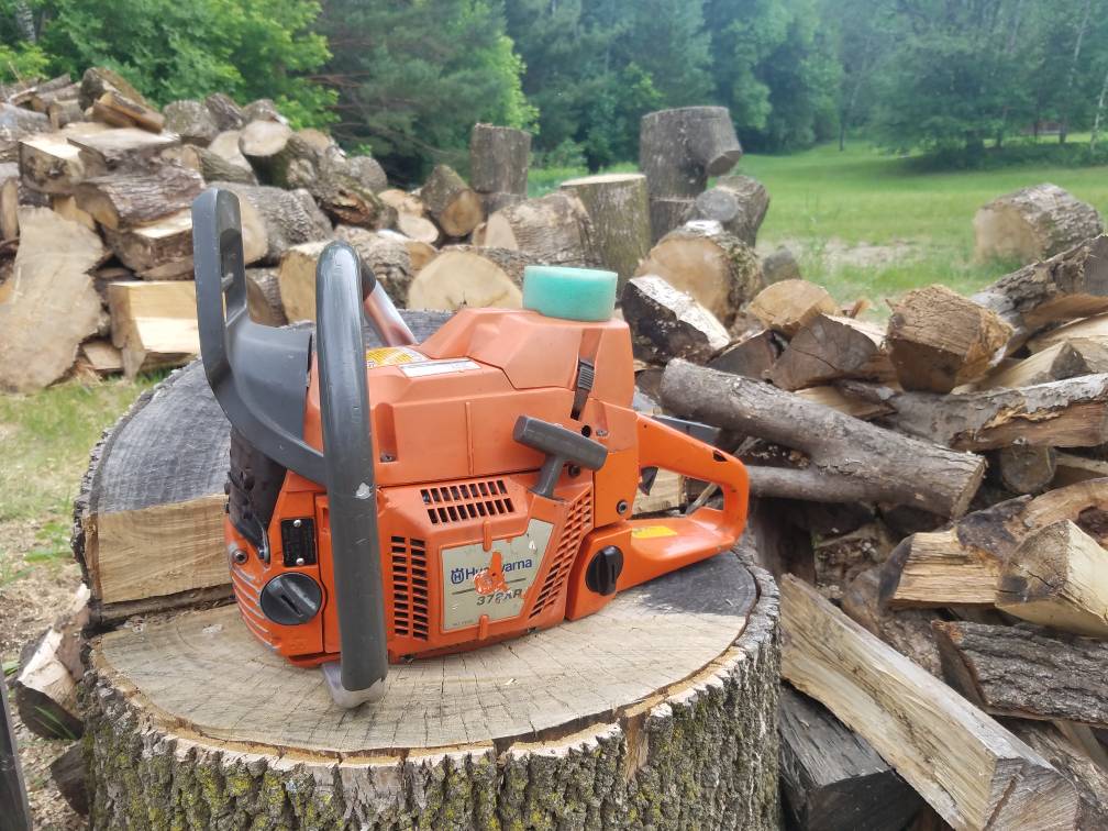

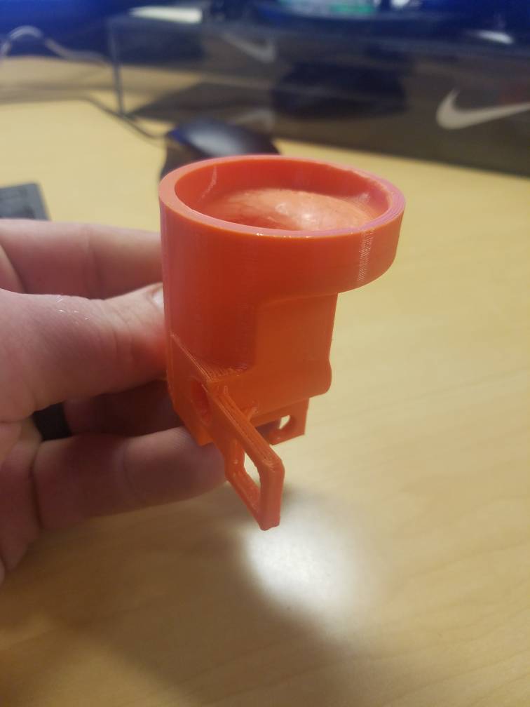

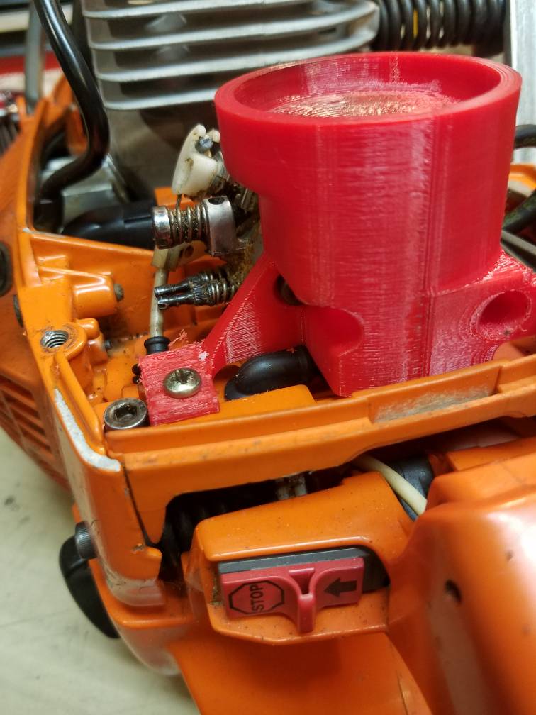

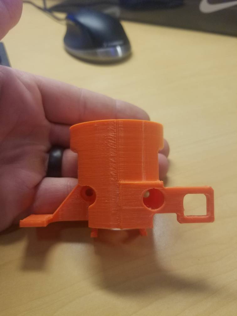

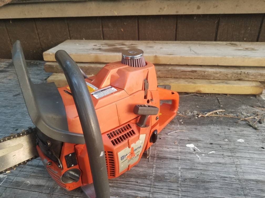

Hey all, I've been working on designing a vstack for the above mentioned saws. I had a few prototypes made and adjusted what i felt was necessary. Here are some pics of what it looks like on a 372. I have added an additional support mount on the lower left. It utilizes a hole that isn't used for anything.
Fits all the good aftermarket air filters most guys run on saws. K&N, Uni-filter etc.
These are available for purchase if anyone would like to have/try it out. Just shoot me a pm.

Is that petg naturally chemical resistant?

PETG might get a bit iffy at those temps. Nylon would be better, I normally print all my engine bay bits from nylon. Too bad you couldnt get the filter to fit under the plastics.

I really dont think the air filter mounts get that hot, do you?
Different filters may fit under the hi top cover.

Melting point of petg is around 450°F.
Should be ok

I'd be more worried about its glass transition temperature and it slowly getting smaller where the filter clamps on.
