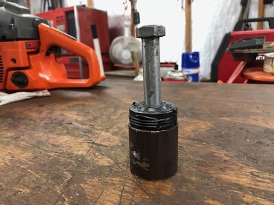

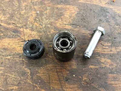

I got to fooling around with some Husqvarna 36-41-136-141-142 saws and their Poulan cousins this summer. They have the same type bearing/seal setup. I found a piece of pipe that the bearing would just slide in to but the seal would not. I actually had to grind out the ID slightly for this to work. I then cut off a 1/2" bolt and rounded the end slightly to help it enter the seal. Tap or press the bolt, pops right apart . To reassemble I use a vise. Use a socket to push against the seal, keep everything square and the bearings will slide right in with little resistance.
The 350 uses different part number seal/bearings, but you should be able to fabricate something similar.

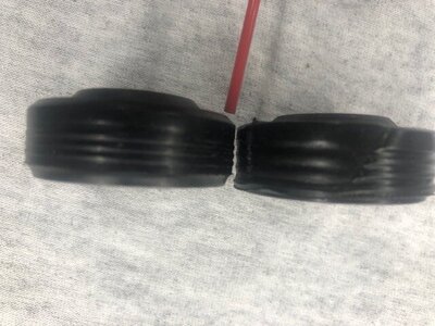

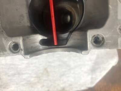

If you are going to try aftermarket seals, I suggest trying HL supply.
The cheapie seals on Ebay/amazon have a rounded edge that may not seal on the cylinder.
The Farmertec ones from HLS have a sharp edge like the OEM ones and worked best for me.
Very nice! Yes I've done the 36/136 and a 141/2 and it's the same concept with the bearings and seals. I'm sure I can find enough in the shop to make it work with the way you have described. I'm guessing, maybe husqvarna sells tools to replicate ur process? Or do they have a different way? Either way your design is nice and simple. I like that. Much appreciated you took the time to show ur work! Thanks!
