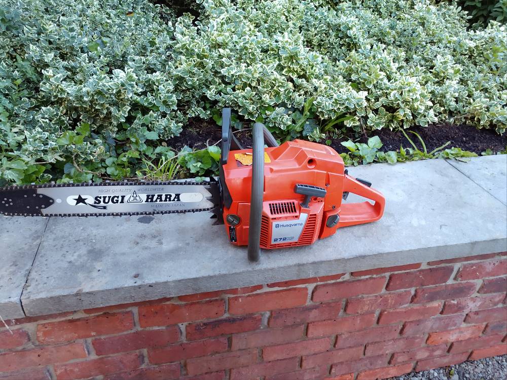

Started out this morning with my ported 266
Ported 2166 and ported 372
By different Porter's.
All 24" handfiled by me
20190903_165826.jpgall three are strong running saws
20190903_165627.jpgi prefer the 266 it's more compact and a bit lighter than the other 2
60cc saw size basically.
Power wise the 372 takes it but it has a 8 pin
The 266 has a 7 pin
But is a bit more maneuverable and balances great with a 24"
The 6.00 china handle bar worked perfectly
I leaned on it hard blocking.
Trying a 9.00 china carb no issue's at all
Just my observations
Everyone's different.
4:21 AM
32,126
182,440
This was the travel on my new 4/92 26820190904_100640.jpgi captured it with a hemostat and replaced it with 4.5 trueblue rope.20190904_100959.jpgsaws a strong runner it pulls a 24" great20190904_102822.jpgi like it runs so good with the open port I'll leave it be
