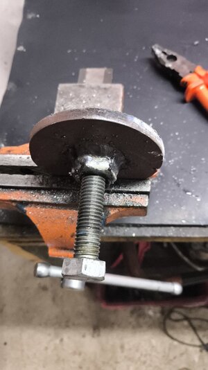

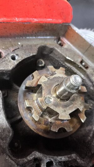

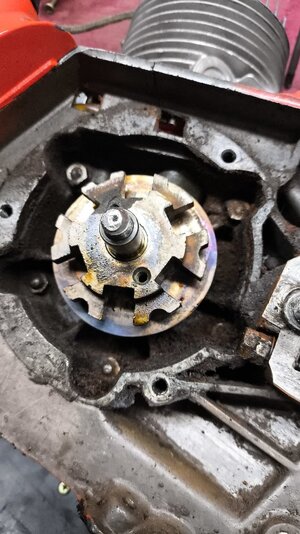

Well years later I finally got the clutch off with no damage. The seal on the clutch side is pretty crispy, and it wasn’t from the torch being out to it because all of the wood shavings weren’t burnt. I just wanted to update the thread for future reference.
