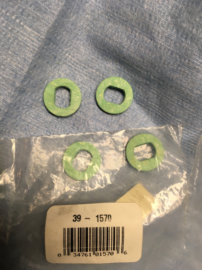

I have had good success by cleaning the friction washers with carb cleaner, letting them dry and then scuffing them up with some sand paper. They should engage quickly with a sharp pull. I've a couple setups with worn cups. With a sharp leading edge and clean/rough (old) friction washers, they still manage to grab well.

File the edge at 45 deg. to a narrow edge but not sharp.
I prick punch the engagement surface of the ‘cup’ every 1/16” or so.
No oil!!! Only a spot of grease on the pulley spindle and silicon lube on a CLEAN spring.
New friction washers used to be on Partstree.com.
Pull gently to engage and then rip.
