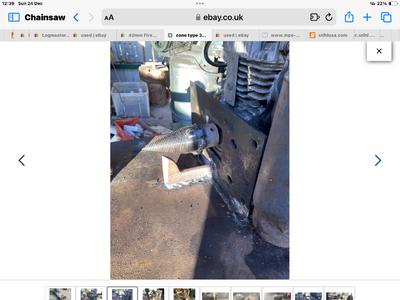

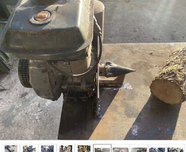

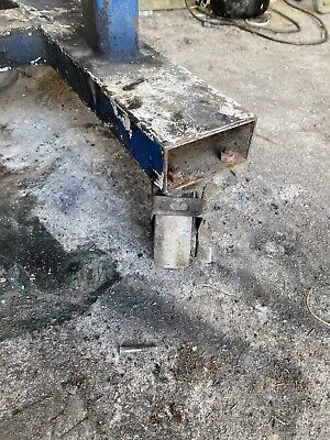

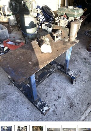

So guys, I,m looking for some advise on this wood splitter on 3bay.. it’s very homemade. The asking price is “buy it now” $508.00
The engine is a kabota 3.5hp
Now I,m definitely not paying that price for something I could knock up with some of the junk I’ve got laying around.
So my question is….. how well would you think this would work and would it be worth me knocking a similar one up ?
Cheers

That type of splitter was available around here many years ago. Sold as an attachment for your car or truck. Jack up and remove one drive wheel and bolt the attachment on in place of the wheel. Start up the vehicle, put it in gear and go for it.
They worked I guess, but where kind of dangerous. You had to push your piece of wood onto this pointed, spinning piece of steel and get out of the way as it jammed itself against the ground and was split open by the screw.
Lots of opportunity to slip and get your gloved hand caught in the screw or have the chunk of wood slip free of the ground and spin around wildly on the end of the screw until you get the vehicle shut down.
With that little engine mounted on a table like that, you are only going to be splitting kindling .
Much better and safer options out there.

I think it’s easier to use a splitting maul and then the bigger wood just rip it .

yes I already have one of them 🙄, it kinda works but,,, as you said it gets jammed and either,, the drill tries to twist your arm off, or the little log smacks you in the ankle 🤦‍♂️🤷‍♂️
I saw a tractor pto mounted version in a vid. It seemed to work, ie you pushed while the log was standing up on the table and the table stopped it from trying to spin around.
I would only be doing small stuff.
I don’t have the need for a $1000 + log splitter and an electric one would just mean getting out a generator as I don’t have mains power where I would be splitting

The problem with that design and a direct drive from a small engine if you stalled it you'd have a hell of a time backing off the screw . Chances are if it was a knotty piece like a fork in the piece you would stall it .A large cone with a PTO or axle drive would have a hard time stalling with about 20 plus HP and a gear reduction .

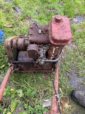

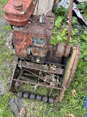

I had a look at the two old lawnmower engines I had sitting around,nprolly for 5yrs 🙄
They got wet/damp un stuffs, corroded etc , one,s got its ht lead chewed, prolly rats 🤦‍♂️
I didn’t get very far in starting them 😴 lack of spark for a start … and that’s after I fannied with the starter so it rewinded.
Ffs its everything wrong with them ?.when i left them working 😫
Btw I’m on the lookout for something else a lot lot better while I still Fanny with these two silly engines.. as these engines are on suffok colt lawnmowers (75cc )from the 1950/60's

Put them online for sale, "ran great when they were put away, no lowballs, I know what I got":risas3:.
Maybe that will translate, maybe not, but stateside, everyone would know what this means, you think your crap is worth the price of gold per ounce lol.
