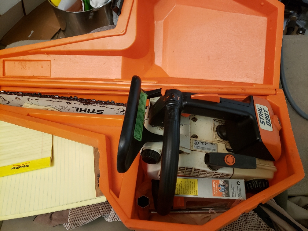

I had problems with buffer and new screw. Handle itself was ok. Had to swallow my pride and have dealer friend help.
Otherwise, a really handy saw.
I lucked out and found perfect small case cheap.
Sent from my SM-G965U using Tapatalk

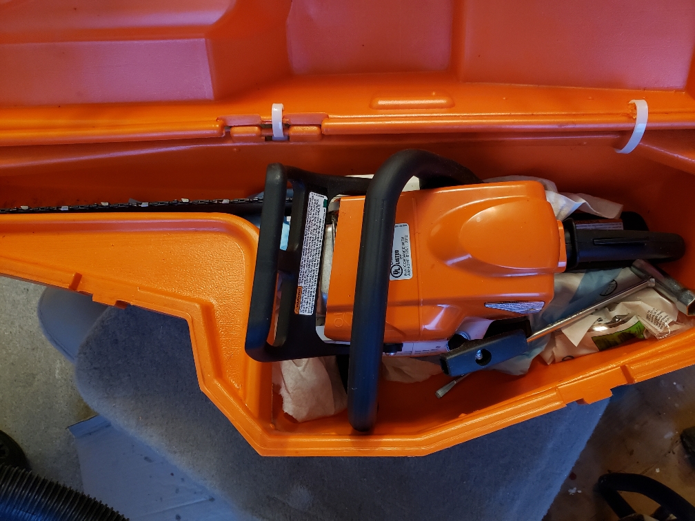

It's a Stihl case. Maybe it was for an 011 or some small saw. Another nice find was case that fit MS 170.
