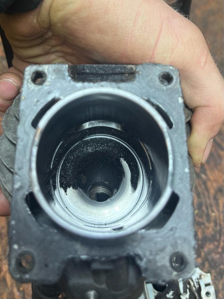

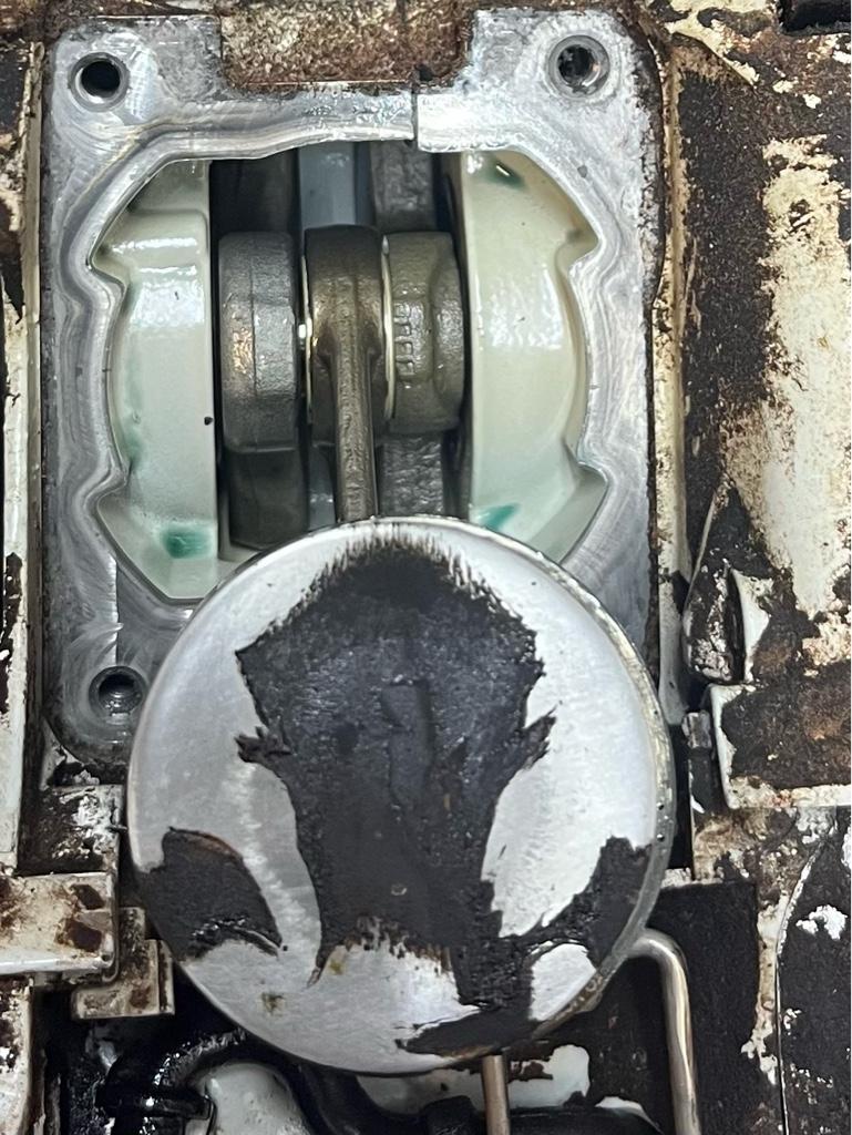

I’m getting a lot of excessive carbon buildup I assume from unburnt charge on the squished band as well as the top of the piston.
Am I gonna blow this saw up and is there something I can do to remedy this?
Also, does the wash pattern tell you guys some thing that I could be doing better?
Running Stihl premium two stroke at 45:1 with 94 octane pump, gas

try some Husqvarna XP+

Change the oil from stihl premium, or any stihl oil, use Husqvarna Xp+
or another good oil.

Google what is the best 2 cycle oil
If you're lucky one or 2 answers will appear.

On a serious note, I have read that stihl oil does not burn well
nor does it lube well, leaves very dry bottom end.

Of the 10 or so oils I have personally used red armor leaves the most oil film in the crankcase. When I pulled the jug on my 372 running red armor the entire insides were red! I have a 4 stroke gasoline burning RC airplane that I use red armor in because of the film I found in that 372.
