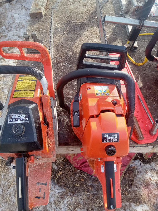

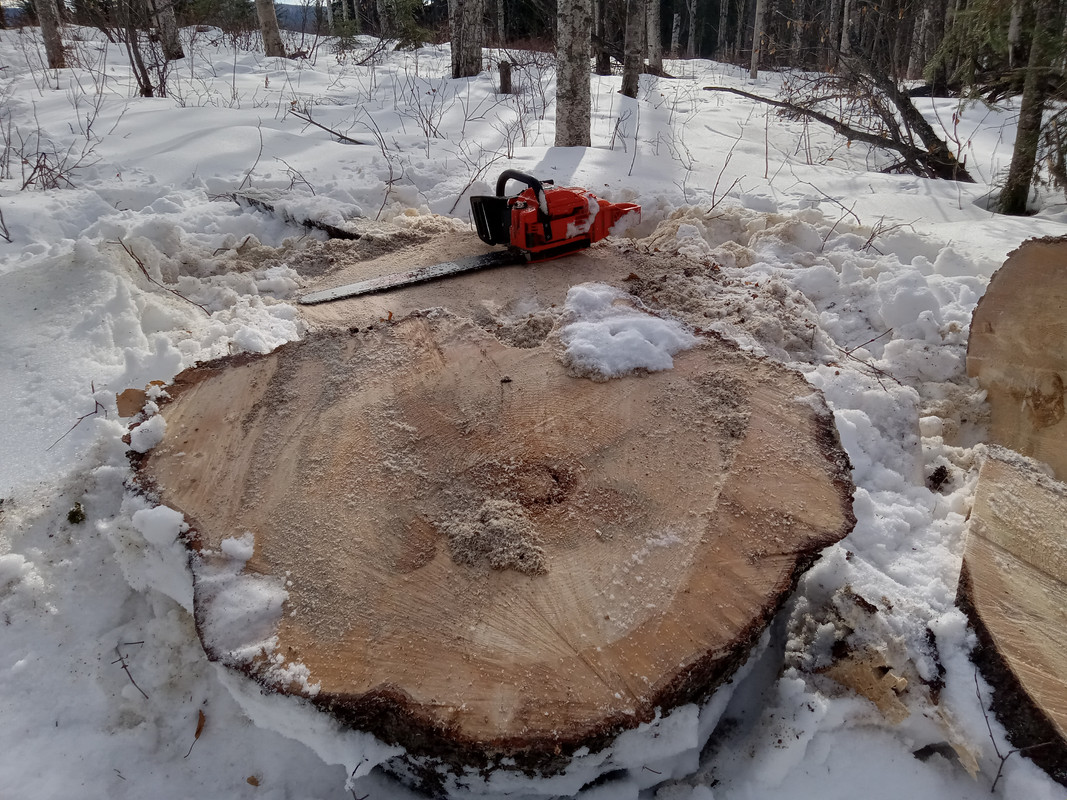

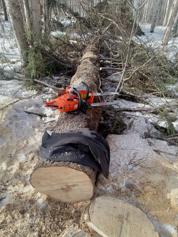

Sorry for the late update. The 6700 had a flywheel issue. Anyhow, prepping large 24-28" diameter spruce logs to be milled with the chainsaw mill I timed some cuts with the same exact chain. The chain was a freshly sharpened 3/8 EXL with 3 strokes off the rakers.
The echo cs 590 and the old cs 6700 are set up EXACTLY the same. Both have mufflers opened up, base gasket delete, timing advance and no port work. The 590 even got a walbro 86-578-1 fuel nozzle in the carb. Both are brand new saws, everything is new on the 6700. Both had a few tanks of fuel run through them to break-in.
The 6700 was 2 seconds faster in the 24" diameter cuts. It's a high-rever. The echo cs 590 was better at cutting down stumps. The 6700 would bog if u didn't baby it through the stump. New school 60 cc's does not equal old school 67 cc's. But honestly, I couldn't pick one over the other.
