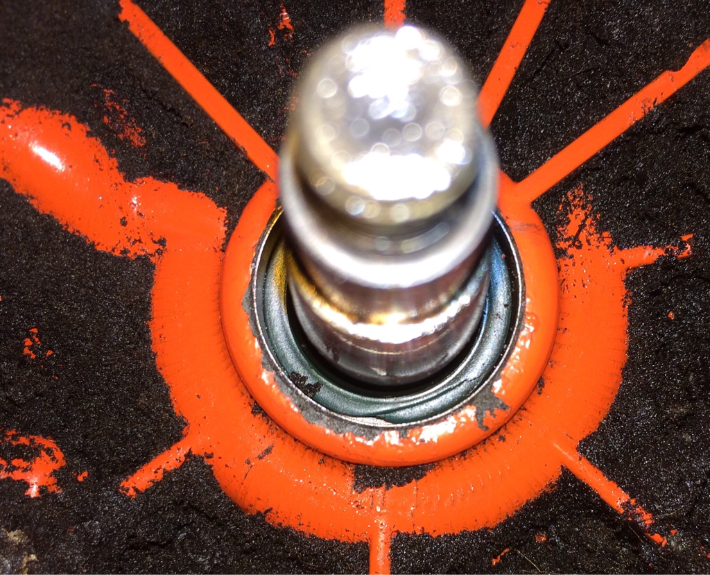

After getting the clutch off I found that this was all that was left of the seal.
An easy $4 fix. A pressure test showed it was OK now so on to the next.

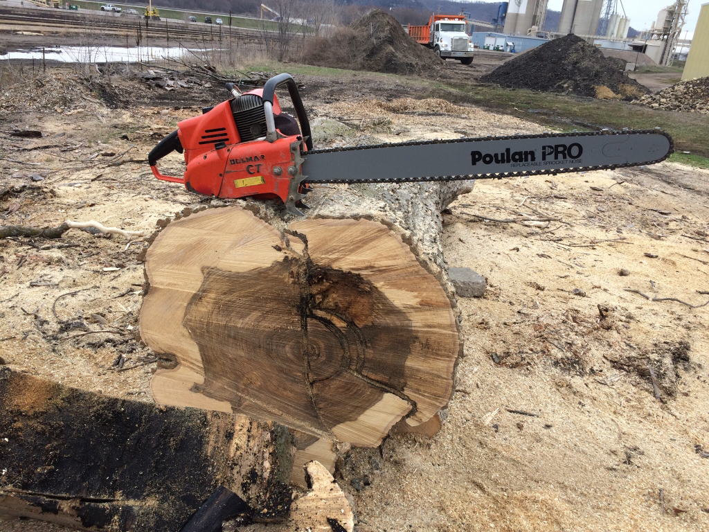

Saw ran but either flooded out or starved, so I put a complete kit in the HL carb. It ran better but cut so crooked with the worn bar that I ended up with a D176 Pattern in .404, 34" off the bay. 3/8 sprockets for this don't seem to be available.

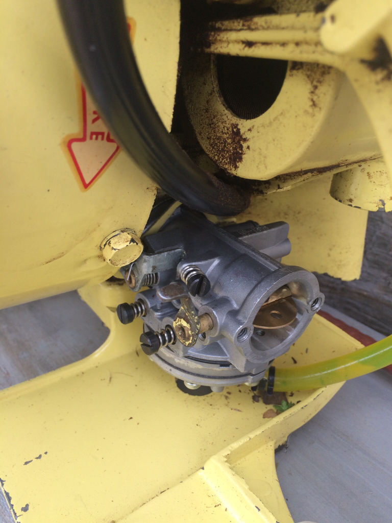

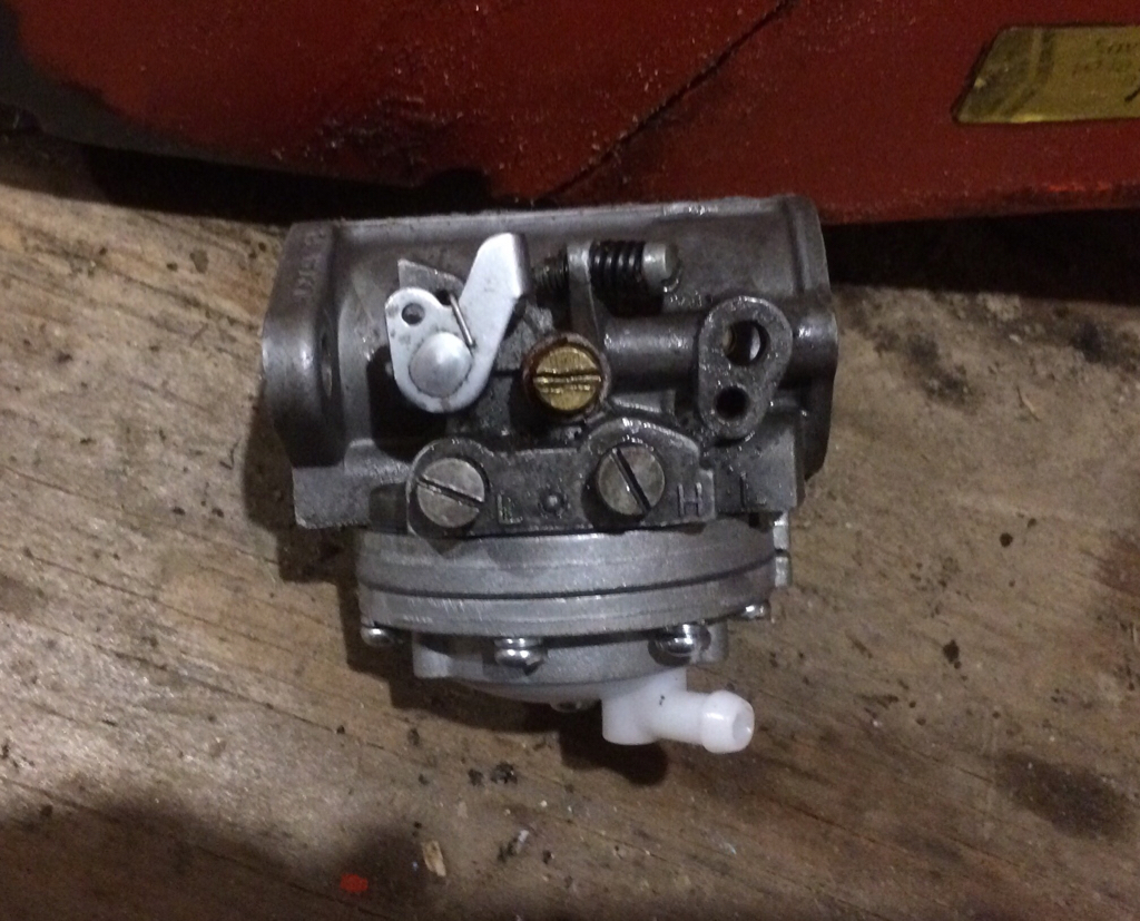

Still, it wouldn't run all the way through a cut so back to the carb. I tried it with and without the governor, to no avail, and for a sort of science project bought myself one of those HL knock off carbs that are supposed to fit an 090.
So last weekend I put the knock off carb on the saw having to change the throttle shaft lever, and a couple of bushings over the Dolmar studs. Only to find the carb would not pump fuel. Rather than waste more time, tonight I traded the metering chamber and the fuel pump from the Tillotson to the knock off body. Thankfully they swapped out perfect.
Old body with clone chambers on it.
The old girl started right up and runs good enough to cut now. I still need to transfer the choke shafts to be complete.

...Awesome saws....never seen one in person.....they are beastly for sure ....any chance that thing will show up at one of our gtgs in the mid west? Keep the pics coming....
Sent from my Moto G Play using Tapatalk
I had it in the car for the Iowa GTG but couldn't attend because our basement flooded two nights prior.
It barely fits in the Prius ya know!

Interested in what the china clone HL has in the fuel pump chamber.
I got my Clinton running but it starves for fuel and won't cut.
Next step is to replace pump guts with genuine Tilly parts.
Fishnuts2
9:47 AM
284
1,025
5,961
SE MN
Tilly parts look the same but pump fuel where the clone would not. I think there was a lot of leaks in the clone. I tried to prime it by pouring fuel in from the tank side of line. It all ran out the bottom by the fuel strainer so I gave up on it and used Tilly parts.
