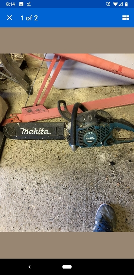

It's a black top. Pictures are a bit crap but it has few scratches and all labels are still on. Where would you guys match one of these to the likes of a Husky or Stihl? I have a 6100 and have had a dolmar 420sc. So I know or the build quality and feel etc of a dolkita.

Right in the middle. 346xp Husky or an early 261 Stihl

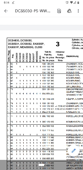

Don't know why Tapatalk won't let me upload decent pics.. but here's one of the saw and also the ipl saying that the 5030 uses the same piston and cylinder as the ea5000p. Guess that means it's a closed port.

5000-5105 (and the 5030) .....Its Mak/Dol pro 50cc class platform . Cat muffler in the latest saws ,Quad port cylinder , MPI coil, easy start pull start (like the 420-6100) and a standard carb. Think of them in similar terms to a Husq 346 xp Mk2....that is a quad port and has the same response. Easy platform to work on.....

older version:
Dolmar 5105 = Makita DCS5030 (5,3 kg)
Makita DCS5031 (decomp vent)
Dolmar 5105H = Makita DCS5032 (heated handle + 0,2 kg)
newer version (muffler with cat):
Dolmar 5105C = Makita EA5000P (5,4 kg)
Dolmar 5105CH = Makita EA5001P (heated handle + 0,2 kg)
