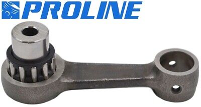

If you could find the bearing it may be worth trying it worst you would be out a bearing and case gasket to put it back together
This is what motivated me to proceed
If I could do it again I would shim it so that I could not go to far pressing it
