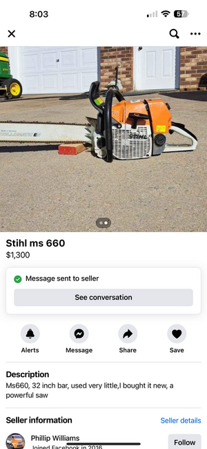

A buddy found this 660 on FB marketplace. Looks suspicious to me. I messaged the guy asking for pics of the serial and some other things. He hasn’t responded back yet, lol.

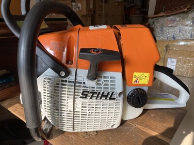

Price is too high but it looks like a Stihl. Gas cap is a clue...

I agree on the too high part! I was thinking the 660 had flippy caps until I did some more research. Most of my Stihls have them except “0xx” series saws.

It looks like an early 660
$600 would be closer to a realistic price, imo, and that would depend on piston inspection, etc.

I’d probably buy this one from a trusted forum seller, plus it’s ported and ready to go.

That's a stihl see the stihl on the flywheel side that's a true stihl chainsaw I am 99% sure.

Stihl knew they would lose all the big saw business if they didn’t keep the screw caps on the 660’s 😂 definitely looks legit, but if he couldn’t tell for sure himself when he got there in person he needs to pass. For that money I’d put a few dollars with it and get a 500i.

I wouldn’t give half that for it, but I’ve got a 661 and 500. How you been brother?

My brothers 660 clone has the Stihl on the flywheel side so even tho that is a good indicator it's not a sure thing tho you can tell the stihl lettering/size is a little off but the stihl on the clutch side likes to close to tell. And the flywheel cover is a china cover not a stihl one on a clone saw.

He may have drawn or painted it on there. The AM stuff doesn’t have the raised letters
