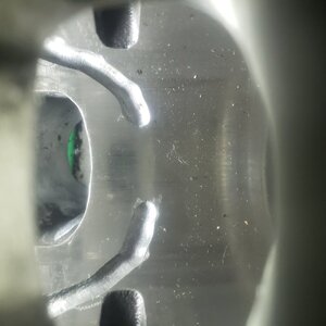

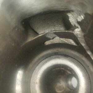

Hey guys, i recently acquired a 084 that was supposedly built to race. Needless to say it didn't perform very well. I pulled the cylinder off and found some odd stuff I have never seen before. Tell me what you think.

I think the guy that was working on that might have watched a YouTube video and said...."Hey, I can do that..." or he might have been drunk or blind at the time. That sucks pulling the top off and seeing that, unless you got a really good deal on the saw.
Iron Pony ,lol

I think you got screwed.
Both finger and bridge ports gone terribly wrong.

You actually might be able to salvage that jug. The hack cut the PTO side tentacle super close to the upper. Other than that, and the fact like they appear to open 10* ahead of the uppers, you actually could get it to run. Even the best quality AM cylinders don’t run or last like an oem jug.
