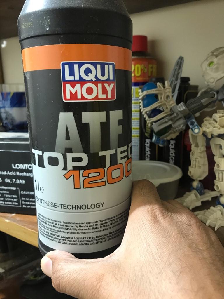

I used synthetic gear lube for years.
I have this around

Yup it’s for my wife automatic transmission car [emoji2363][emoji2363]
If you can get bar oil, any bar oil, use that. If not, I had good luck with Mobil 1 synthetic gear lube for years. I'm not a fire wood cutter but it was recommended to me buy a former supervisor / diesel mechanic that used it.

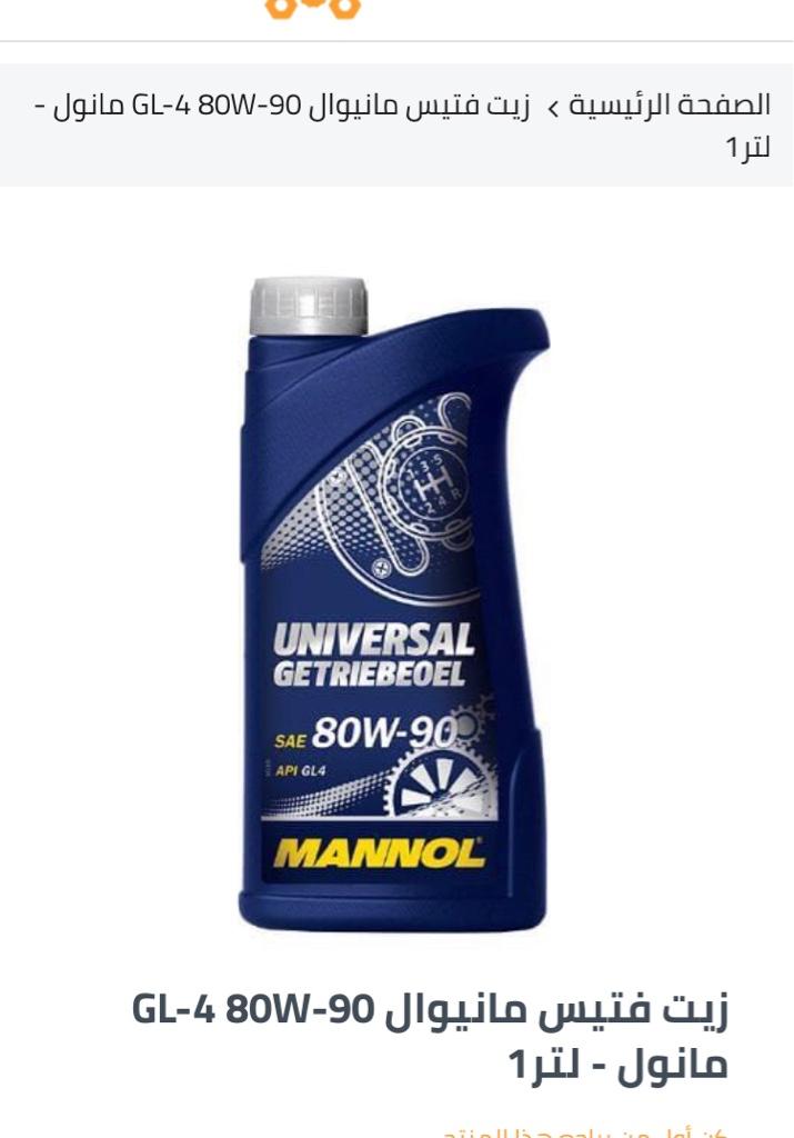

Unfortunately we don’t have bar oil around as chain sawing is not that popular for consumers [emoji85]. Sure we have Mobil 1 oil for motors and auto transmission, yet you need it to be normal transmission. Right ?!
Gear oil like what is in the rear axle. 85w90, 85w140 ect.

A member used to give us a dozen gallons or more of gear oil. Wherever he worked went through a lot of it. I think he added a tackifier (STP oil treatment maybe). At the time, we could have gotten a truck load if we wanted it. Good stuff. As good, if not better than any bar oil IMO, not that I could tell the difference, lol.
