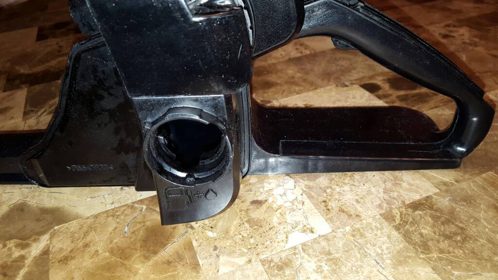

So far black rit dye works really well on stihl and husqvarna covers. But I wonder if solvent dyes might penetrate deeper.

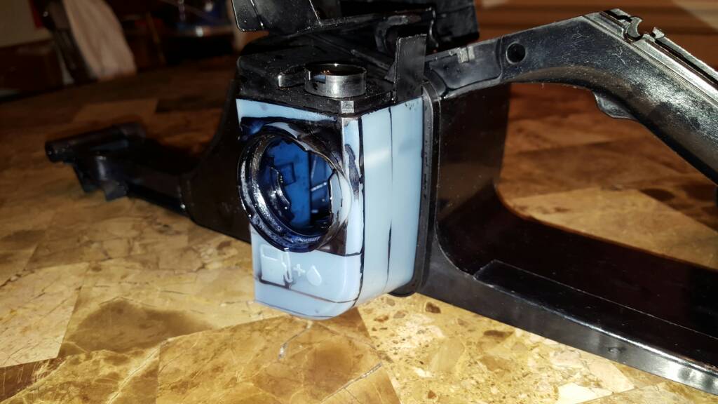

Has anybody tryed to die the translucent fuel tanks like on the husky 359/357 and 372? Just curious if those will take the die because i have a 357 im building and was thinking of going the black root.

You could try just the bit at the front mount submerged.

It will take, but no longer be translucent.

I know the Stihl ones accept the dye!

That's what i wanted to know. Don't care if i can't see through
Here's how mine went. I tried to mask it off and keep it transparent. That part failed but still turned out great!
