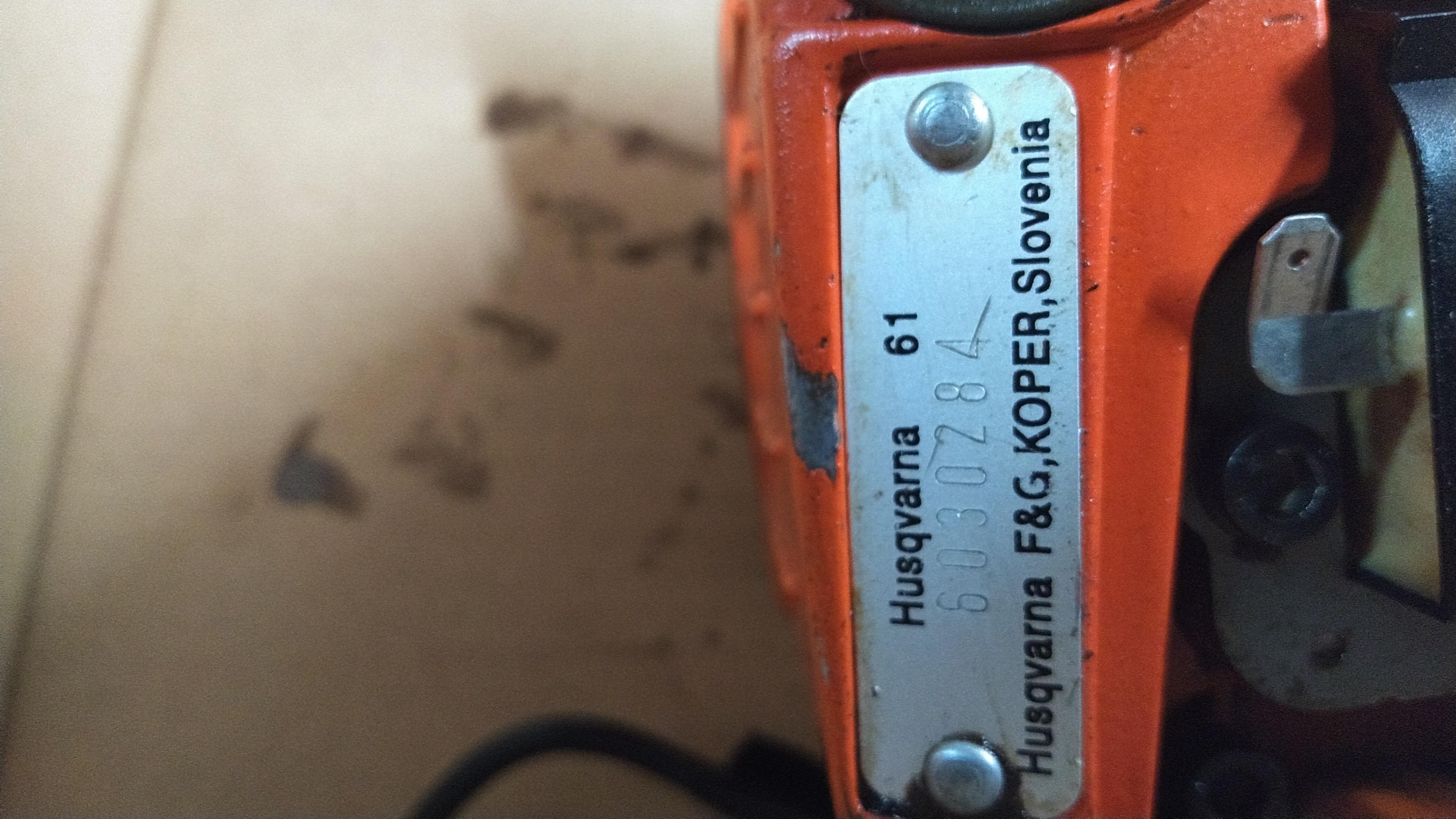

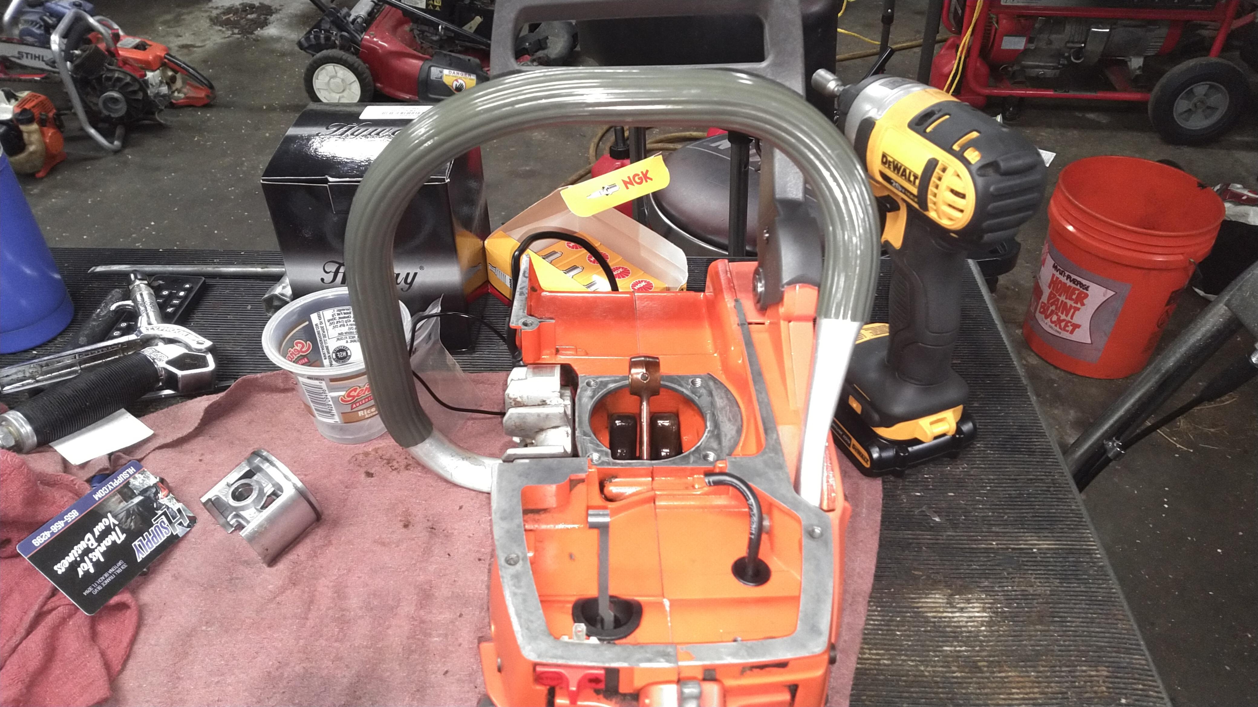

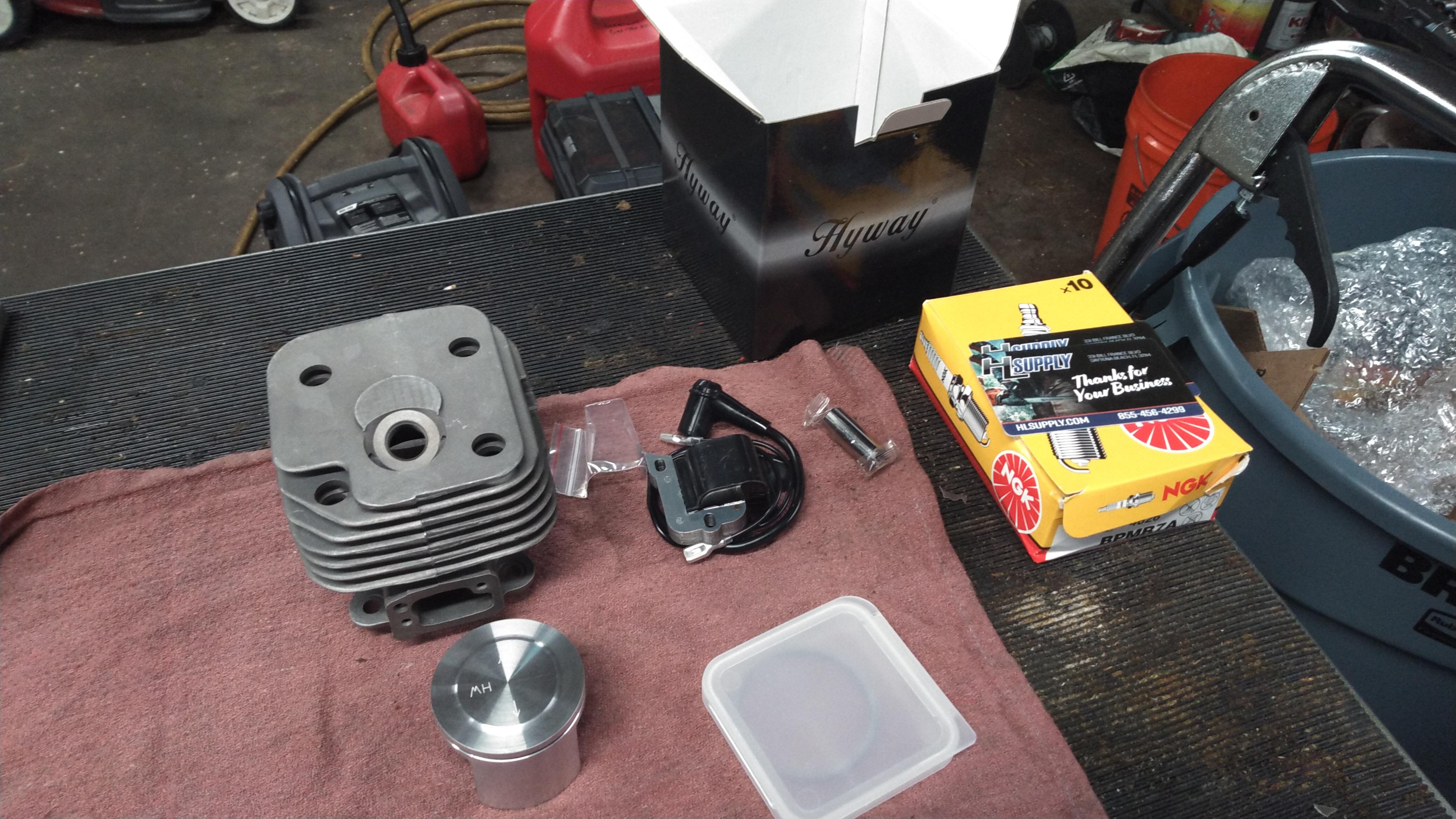

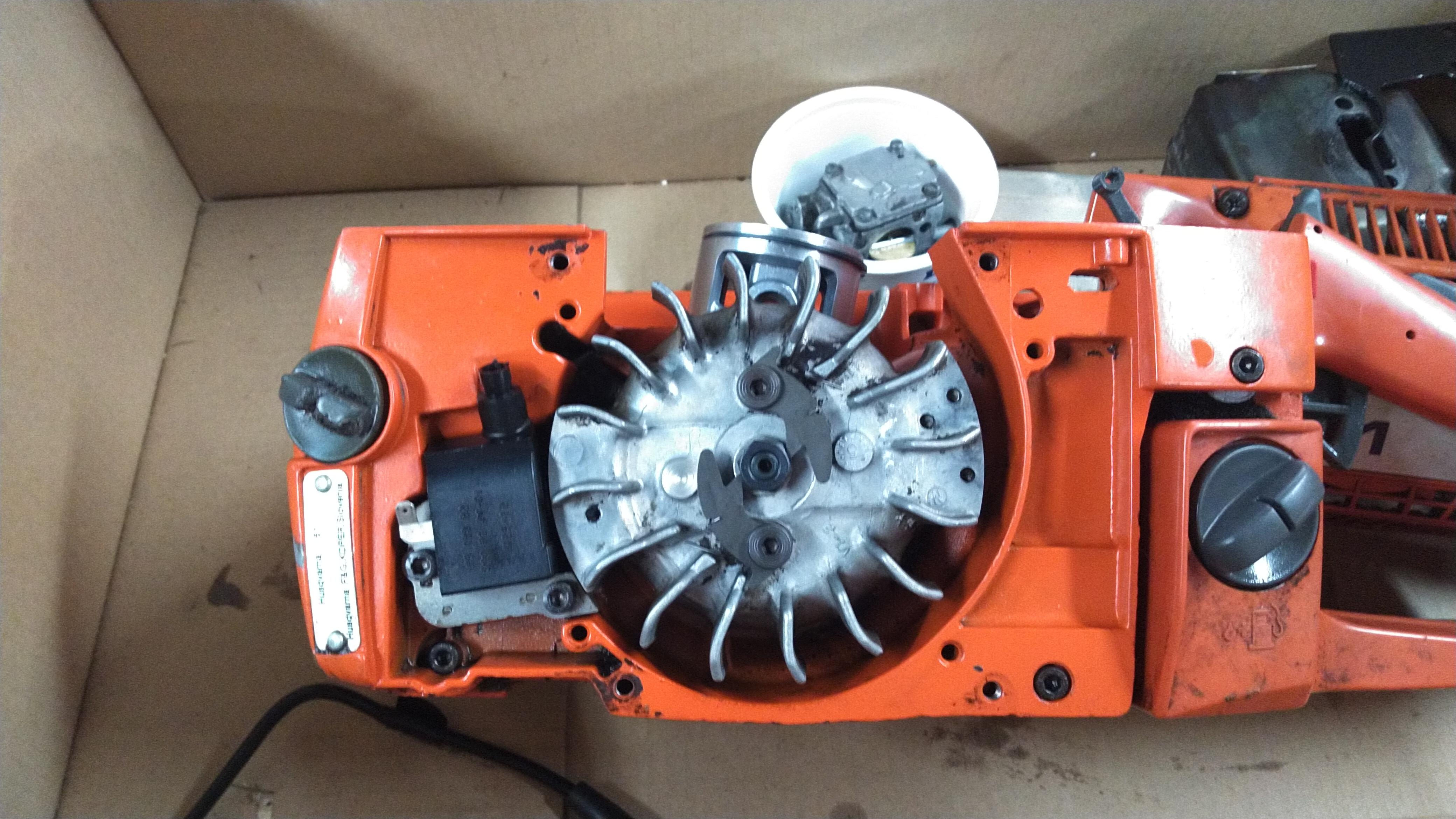

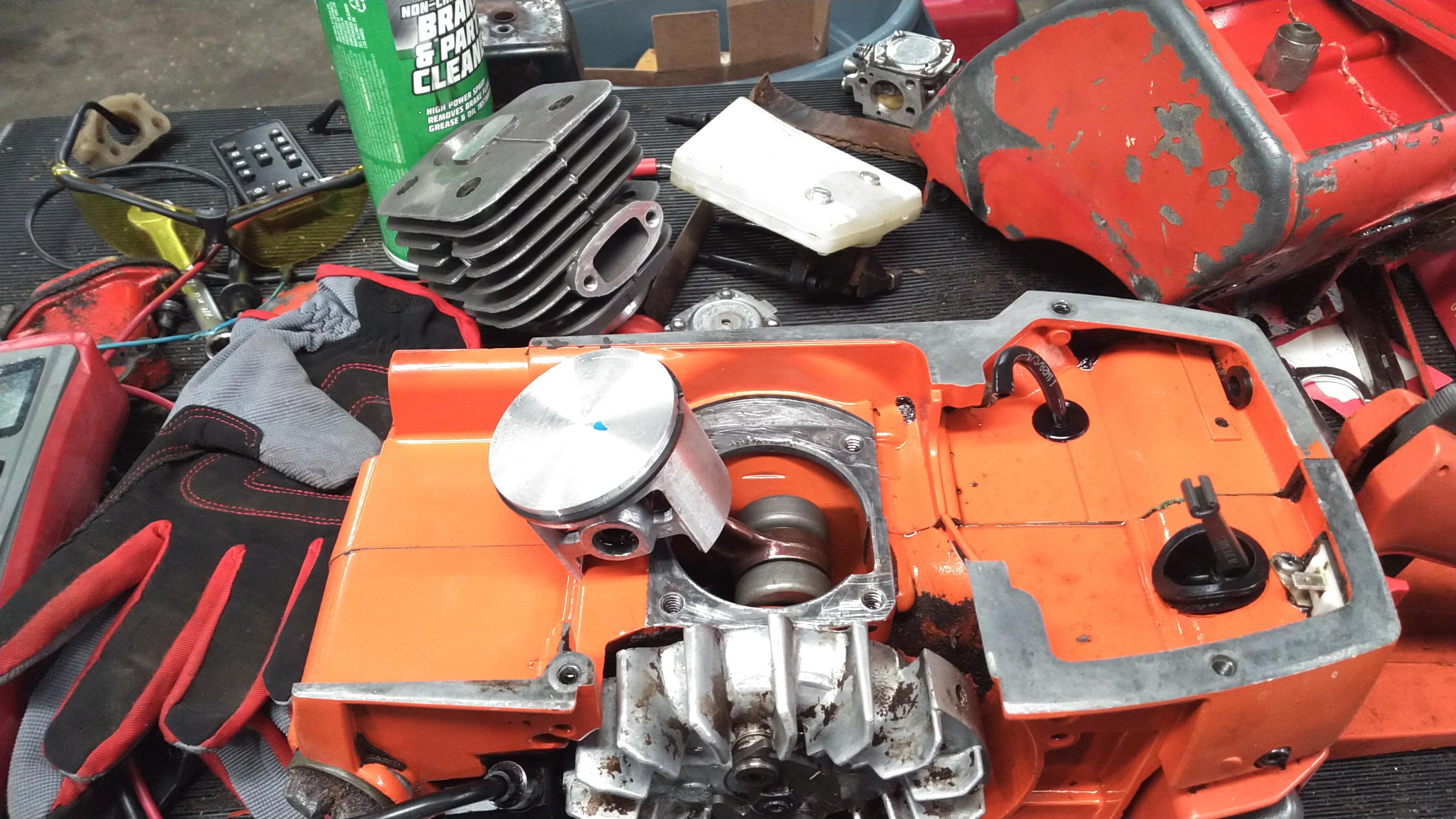

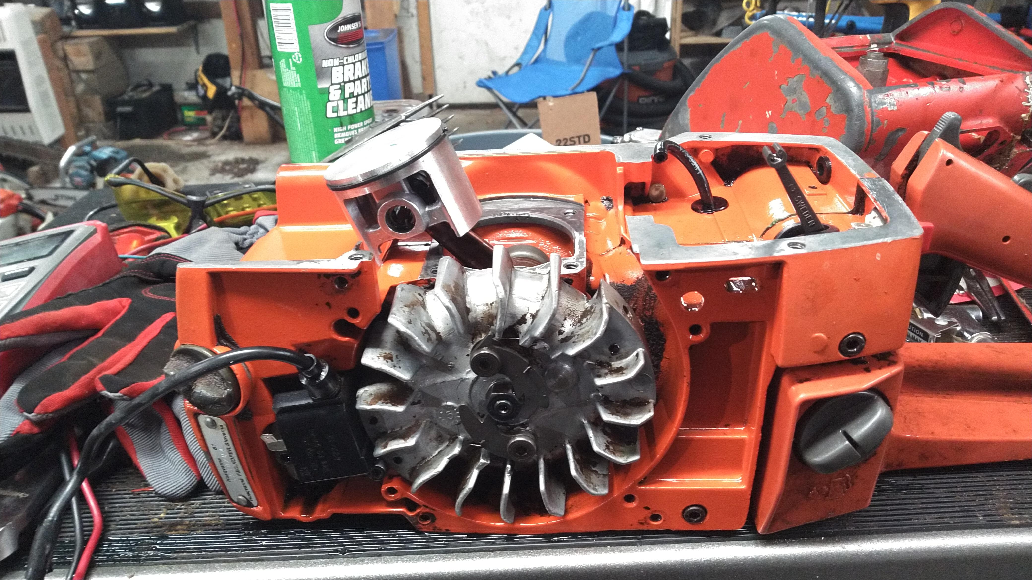

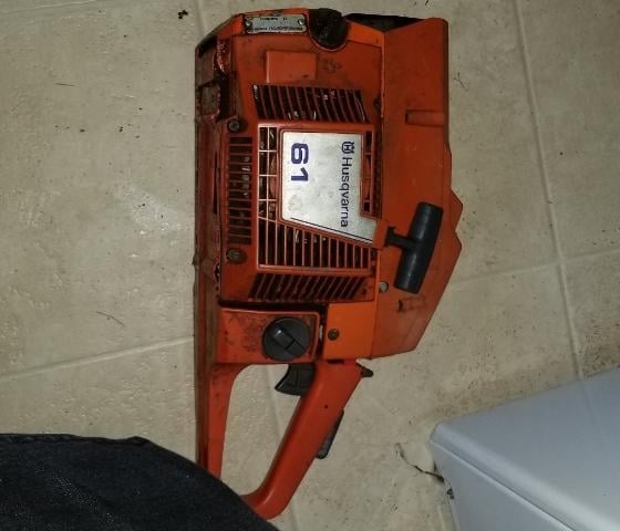

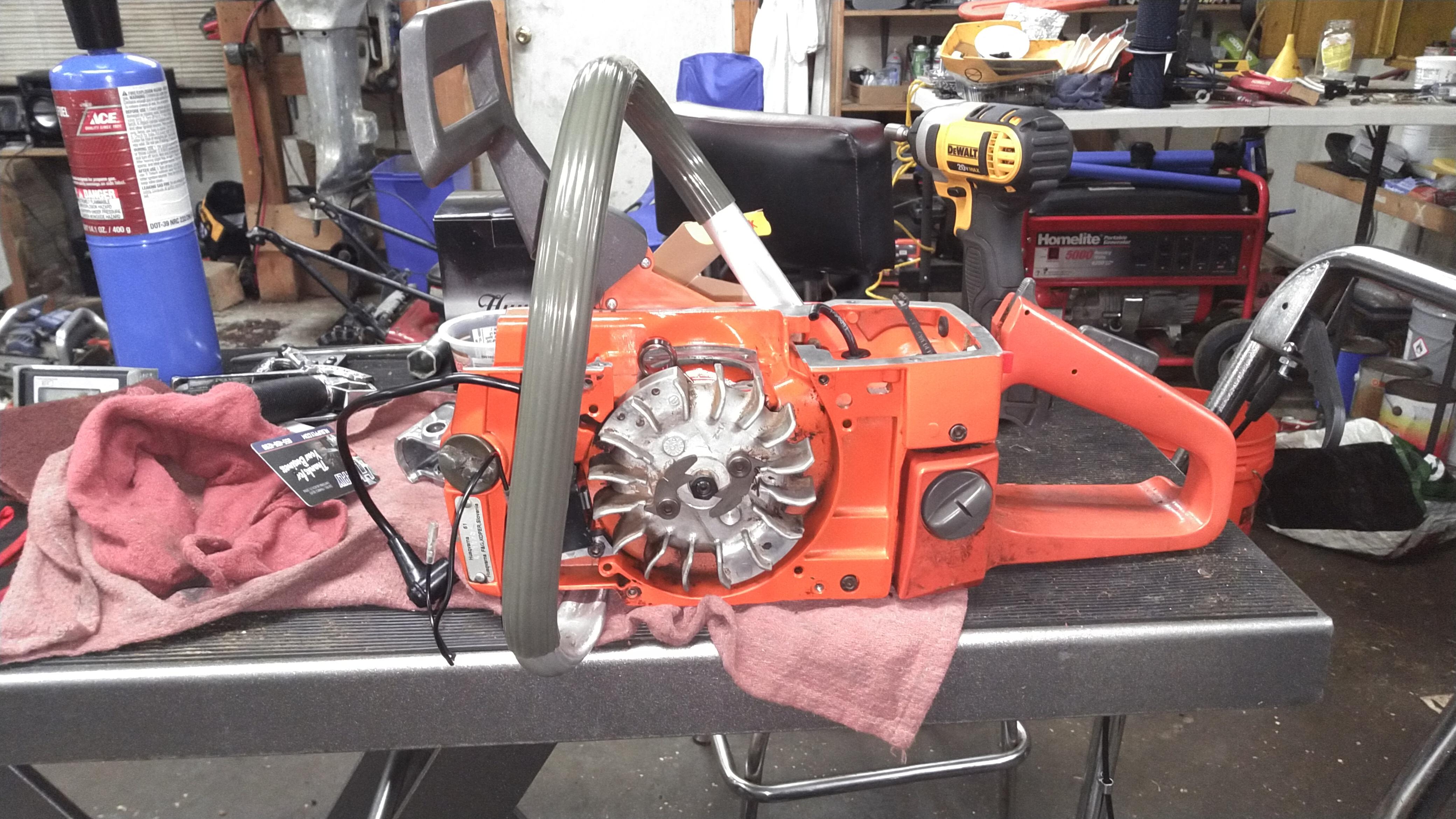

Decided to build myself a mid sized Husky to go along with my Stihl 034. Found a 61 with a 272 top end on it so that's what I have decided to build. Last night I cleaned it up in the solvent tank and did a bunch of inspection and parts ordering. Have a Hyway pop up piston cylinder kit and more stock of BPMR7As coming from HL Supply. Have a bunch of stuff coming from eBay as well. Here's pics and a video!

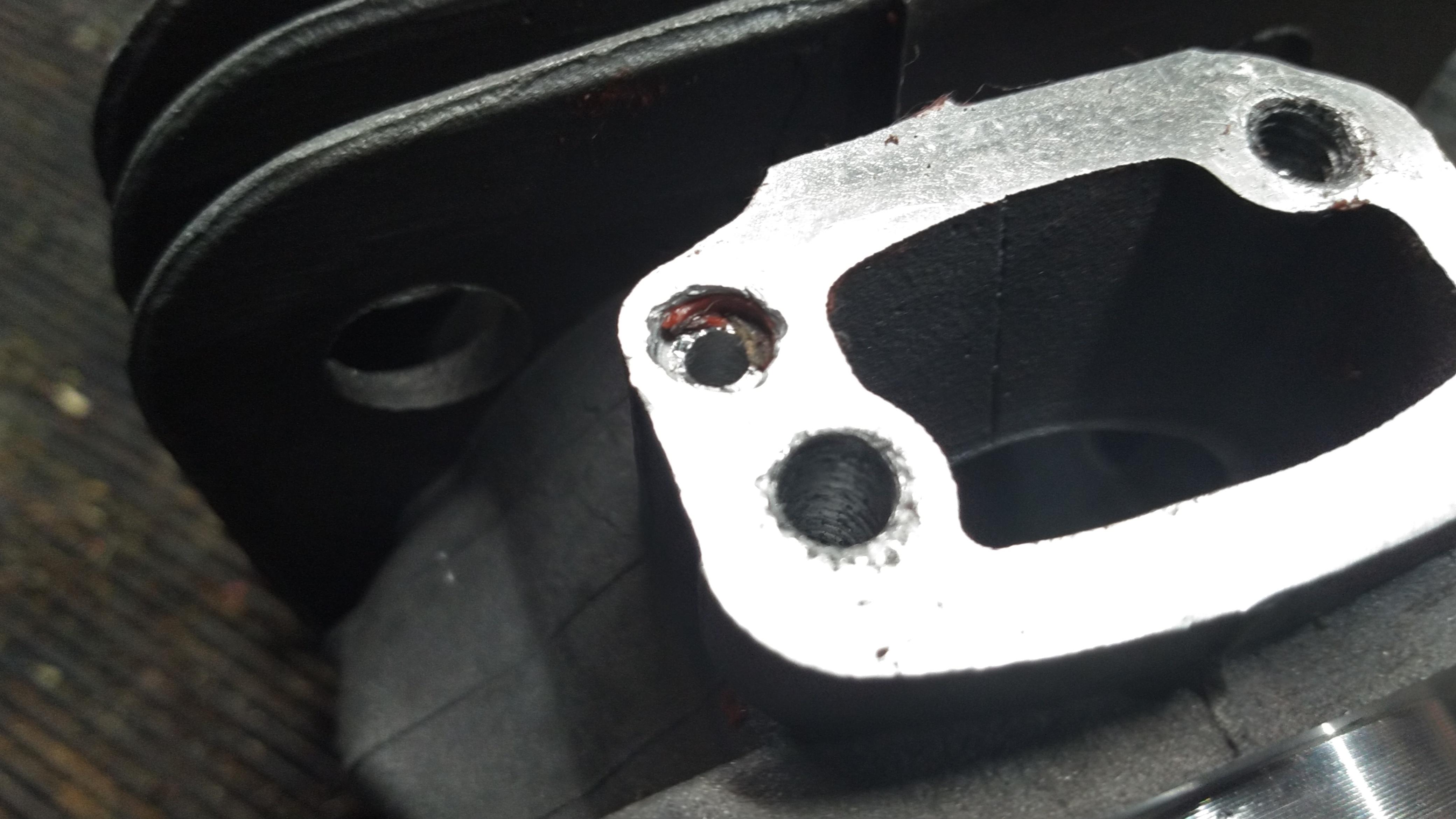

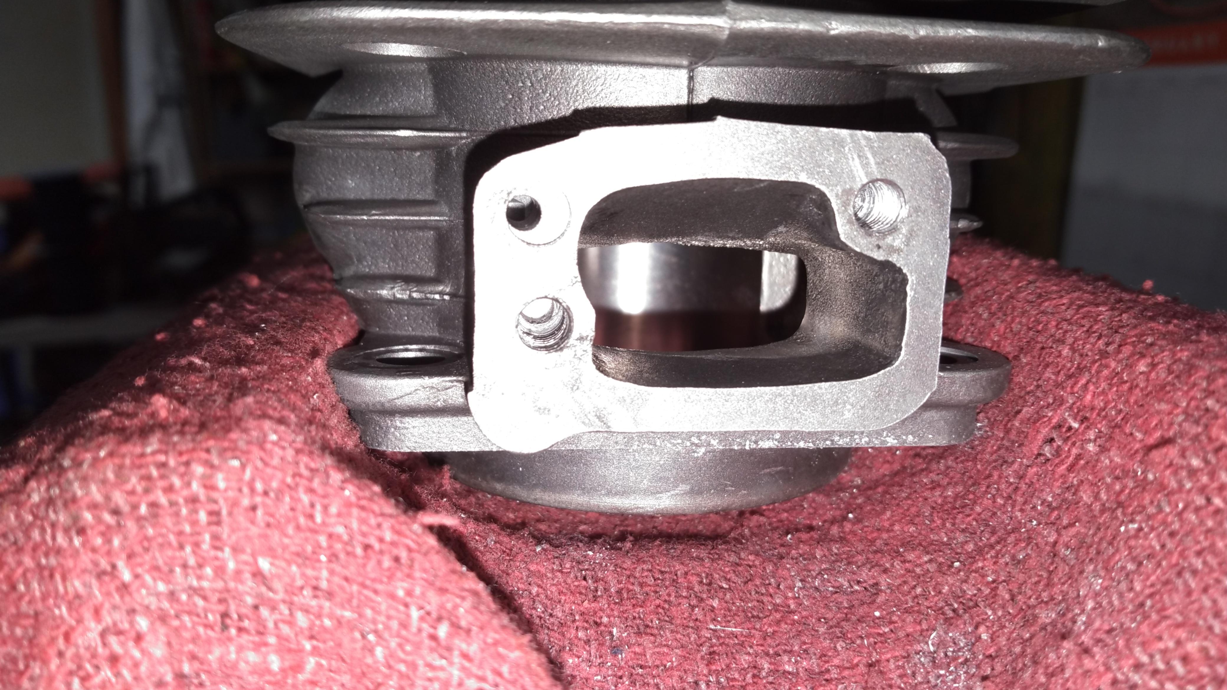

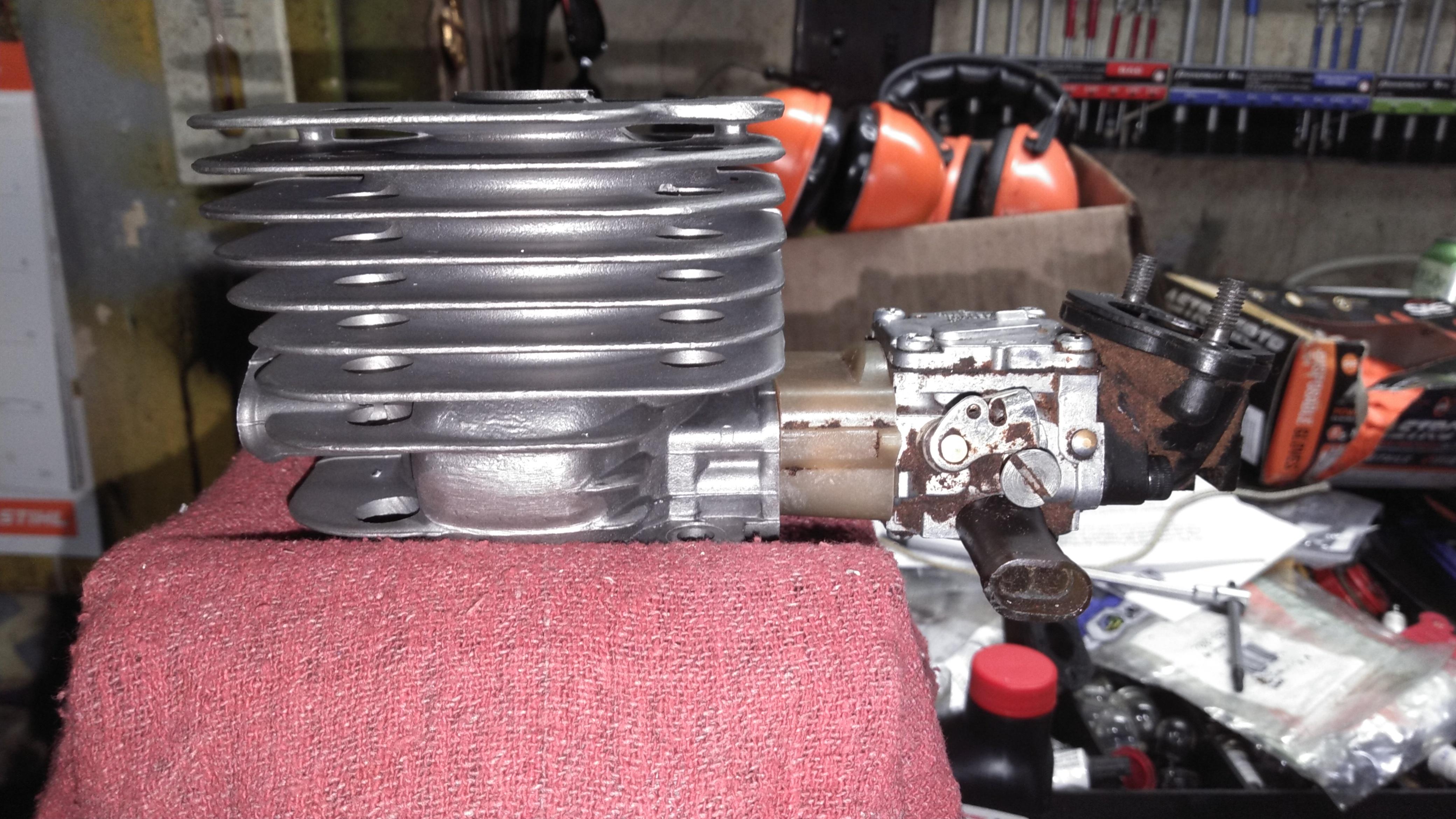

That's a new crappy Chinese 272 cylinder. One carb screw is stripped and there's a crack in the intake passage.
I just bought a new oem mahle 272 cylinder kit for $120 off ebay and i think there are more. Just a few bucks more for better quality

I'm not using that cylinder. I've decided to go with a Hyway kit.

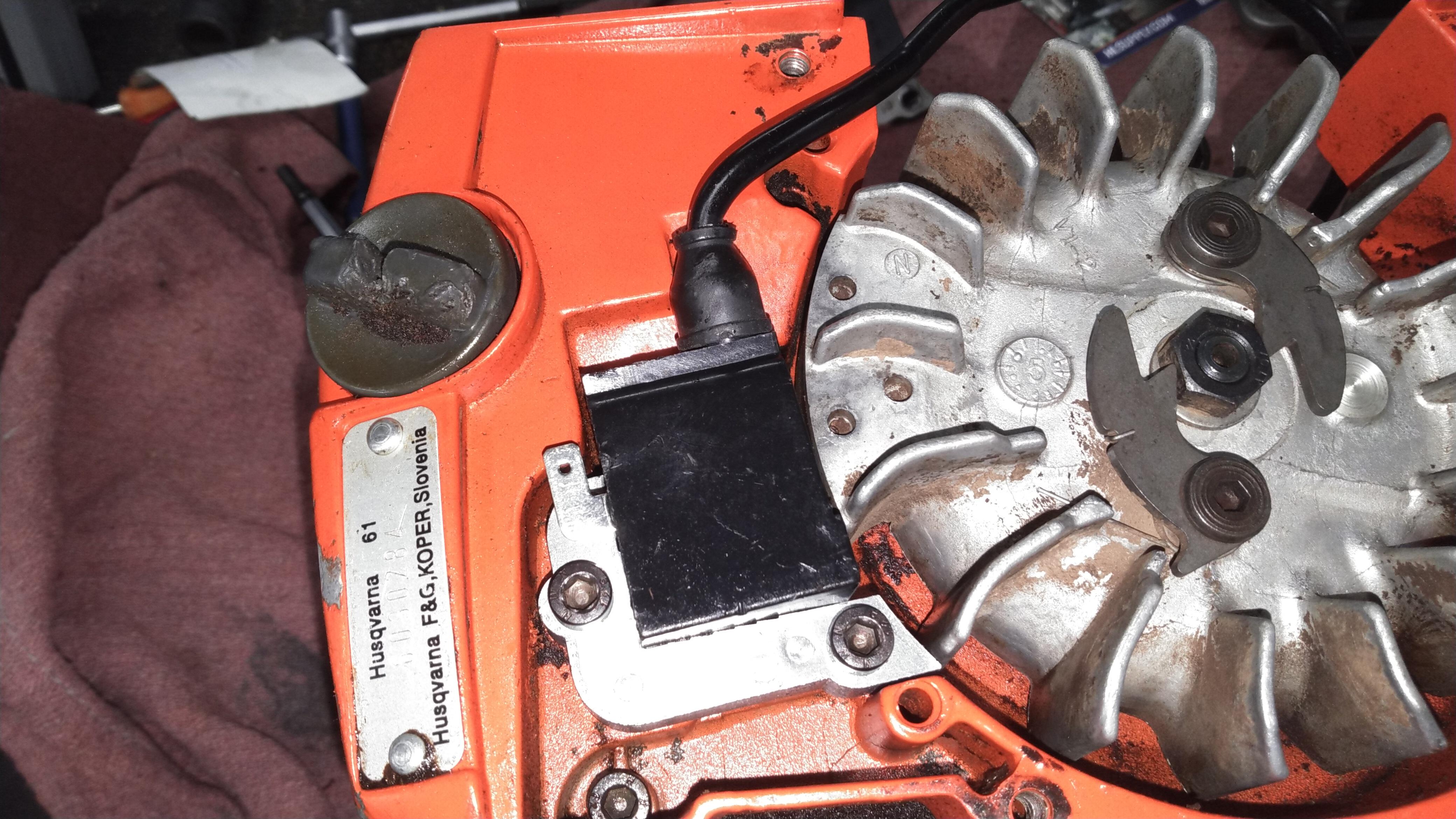

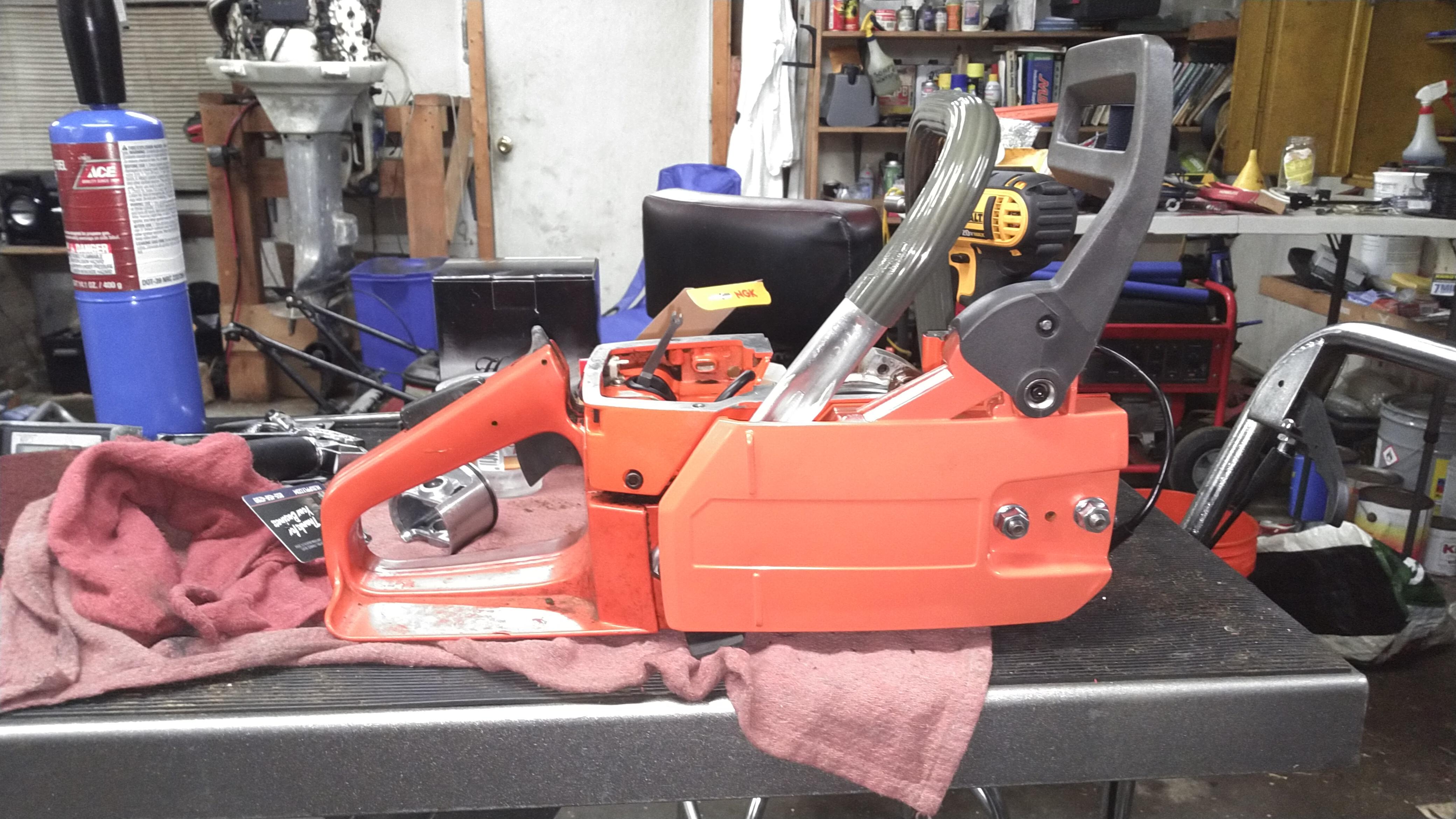

Progress this evening. Still waiting for muffler kit with hardware, bracket and gaskets, a choke knob and bucking spike. Drilled and tapped carb bolt holes in the jug to 5mm x .8. Replaced coil which was dead. Hope to have it pop possibly this weekend. Haven't touched the carb yet, should probably do that.

Totally forgot to post an update, but she's running now! Seems to run very well. Bar and chain combo will be here Tuesday or so and then I can get her in the wood for break-in.
