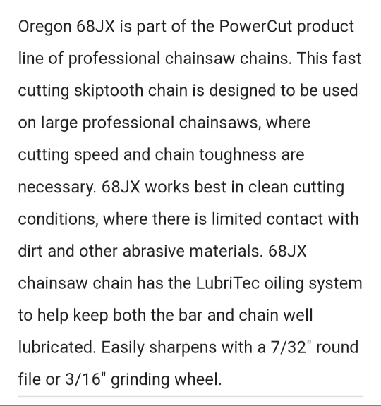

I used Google to double check myself and Baileys says 7/32 file or 3/16 wheel for sharpening. Then father down they say three sided chisel bit file?
I sharpen that chain with a 3/16 Diamond cbn wheel .
