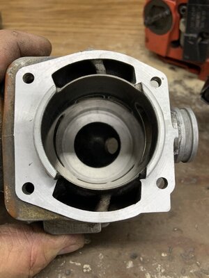

So after cutting base and squish band I'm at 103/130/80 .024
Thoughts on how it run? Thought I might run it first before I grind on it. I unshrouded the lowers and cleaned up the in and out.
just curious if anyone has ran numbers similar to this as mostly peeps run 100/120/75 or thereabouts.

I wouldn’t raise the exhaust if I didn’t have the ability to raise the transfers. Your last numbers will work fine if you can raise them, although the intake will be closer to 79 after machine work
As Kevin said, you gotta raise the transfers.

Ditto on what was stated previously. 100-120-80 is a very solid set of numbers in a 372 provided it is all grinded well.

Sound good. Thanks fellas. Figured some one has tried the longer blow down numbers. I'll get the grinder fired up!
