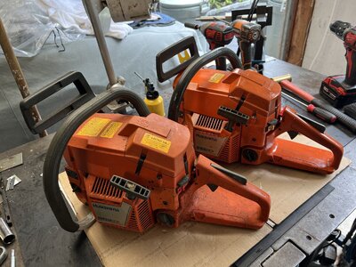

Found a few donor saws. Hope to get to the saws in the next few weeks. Of these 2 saws, one is decomp/120 carbed and one is ND with an 87.
I actually prefer the decomp jugs and the 120 carbed version.
The 120 carb is too small for a ported 262, but it’s fine for a stocker. The plan is to convert a new OEM 199 to 87 specs using the current 120 as the donor carb.
The converted 198/9 carbs actually have the same Venturi as the 87 and are easier to tune. They provide the same WOT power with better low and mid-range than the coveted 87 does. More work though.

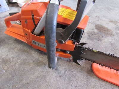

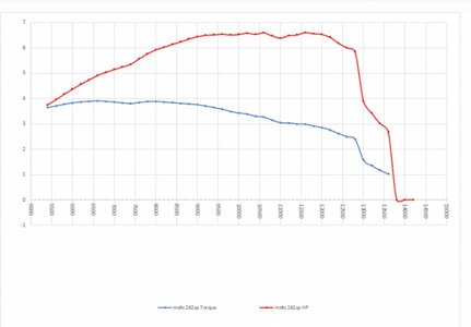

I found the thread you guys discussed the 198/9. Is it just swapping throttle and choke rods? Whats the difference between the two, I think I read an accelerator pump? That dyno run is alot smoother and slightly longer in the powerband by 500ish rpm on both ends from the ones you had in the other thread. I guess my question Is, what did you think that worked that you changed from the earlier iterations? I also recall that you said in the other thread the strongest was the saw with the longest exhaust. Any chance you remember/wrote down the degree's of those 3 262s? If that's protected information that's fine too. On another note anybody notice the mag/pro clutch cover? I've had 10+ 257/261/262's. Most with the madsen's wrap, but this is the only one I've seen without the plastic clutch cover and the only set of these dogs I've seen. Its previous life was in an orchard and the machine marks are still on the og piston. I keep half ass hunting for a used oem cylinder to preserve the original, but don't ever seem to see one on the bay. I probably shouldn't care.

The metal clutch cover is generally a 261 item, but I’ve read that it was available as in the 262 at one point. Usually the 262 cases have the two slots in them to locate the plastic clutch cover tabs.
That extra outer spike. It usually doesn’t line up with the inner spike. It’s a pita I generally don’t care for, but I’ve had a few saws with the duals. They are way out of alignment from the factory.
Not sure what thread you are referring to with the Dyno curves. Feel free to add them into this thread. I only searched Joe’s thread and found this one curve. I recall it making more, but I could be wrong.

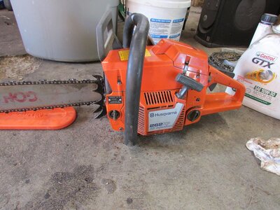

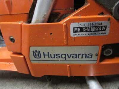

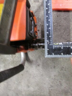

So the 198 no pump, the 199 is the one i seek. You posted a video of you runnin 3 262's and some graphs. Mines a 1996 so, decomp 120. I'm excited for the info. Thanks in advanced. also my dogs line up. I've had the lame factory outers/inners. This one came setup this way from mr chainsaw in eugene oregon. I assume according to the sticker on the chain brake. My one handed camera game is questionable so my assumption probably is too.
I think this is it, i might have been reading with beverages.
I think the exhaust in my 353 is at 104 or 5 and i like it like that, it turns a tad over stock but pulls real hard.

I checked a couple ipls and my 1994 262 ipl does show the clutch cover with the tabs, my later ones do not.

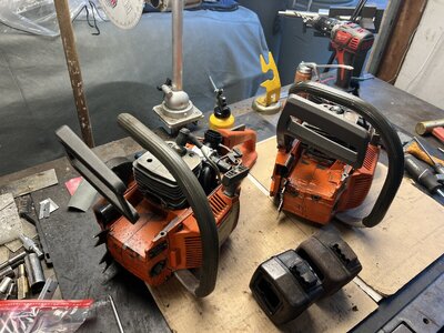

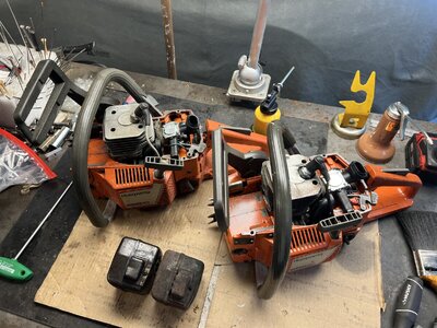

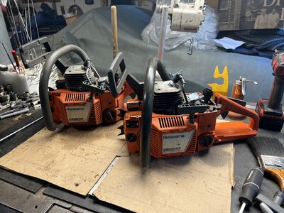

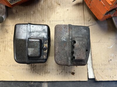

About to start some surgery on these 2 boys.
As you can see, both mufkins have brazed on deflectors. Just like @farminkarman 257 muffler can.
Personally, I’ve only seen 261’s with the easier screw on deflector. I just cut these in 2 spots in the axis of the saw body, fold the top of the deflector back to do my thing, then fold back into its original position. Then I cut the teeth off, tig braze it back together, and pry the deflector open to a half moon.
Unfortunately, the older model (0200 SN) has the carb replaced with the *s-wordtiest of all, the 144. Unlike the 120, the 144 throttle shaft won’t accept the 87/198/199 butterfly without slotting it larger. Just an annoying extra step.
