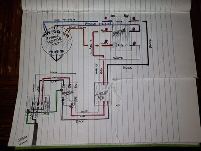

That I do not know. I mapped out the wiring of the lathe and found a diagram/instructions.
I'll have to go see later.

I think this converters issue has been narrowed down to a faulty switch/relay.

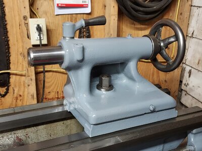

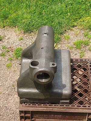

I still haven't messed with the Static Converter... I did finish the tailstock ram/quill as well as the Taper attachment clamp.

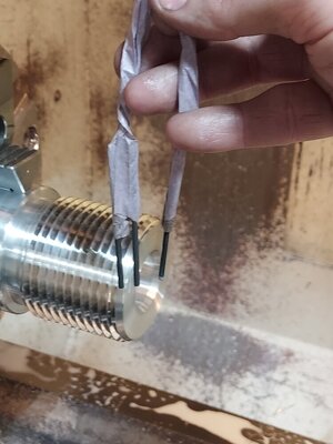

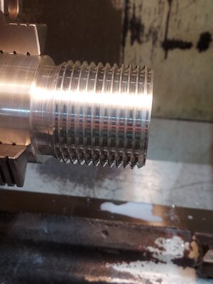

Machined a Go-Nogo Gage for the Chuck adapter (2-3/8"-16tpi) that I'll be machining once this 16" South Bend is up and running. Good ol' 3-wire method for the win.

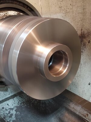

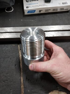

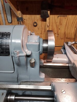

A little lathe work on the chuck adapter... The spud fits nicely.

I don't reverse while threading... I disengage, pull-out, reset and follow the same lead... sometimes i use slant depth other times i use straight depth... I always use the 3 wire method for checking threads... But, to each their own.

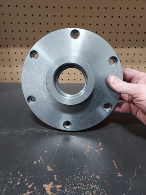

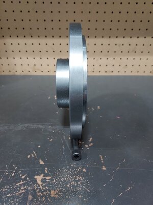

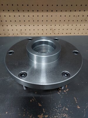

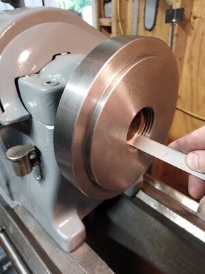

We have a Nice Snug fit to the spindle, absolutely no slop in the thread engagement... to finish this up, I need to machine approximately 1/2" from the faces. I want to make the adapter flush with the spindle. In doing so, I'll gain center to center distance and I'll have less rotating mass to help on the starts. I have to drill 6 through-holes then finish them off with counter bores and I'll be able to mount the 3-jaw.

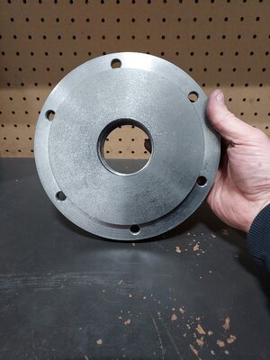

Punched some holes and counter bores into the adapter... the final/truing cuts will be the South Bend.

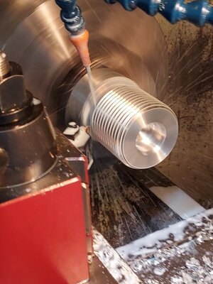

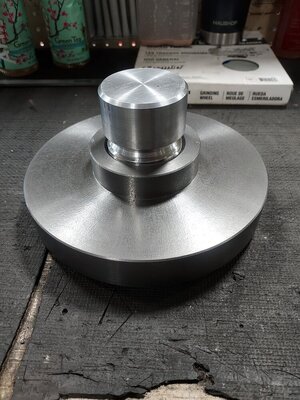

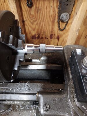

Turning a Super Secret Part for a Super Secret Project on the 9" South Bend. The finish isn't the greatest but, this lathe can still hold a tight tolerance.
