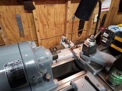

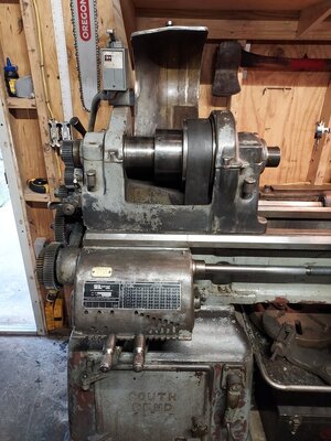

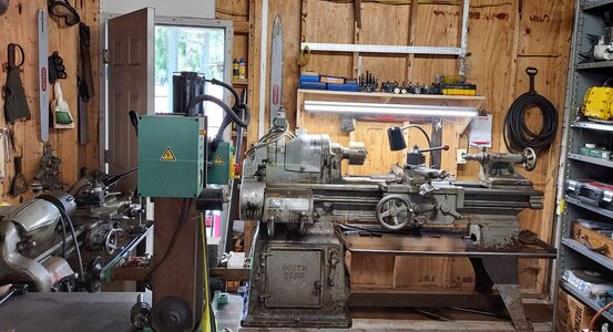

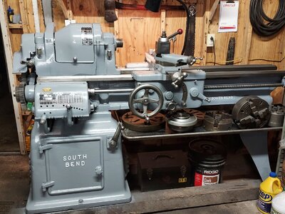

Went ahead and removed the old paint... degreased, heated and painted it. Rebuilt the Taper attachment and made a new cross-slide nut.

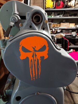

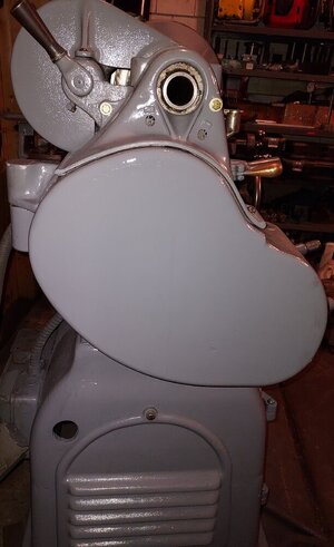

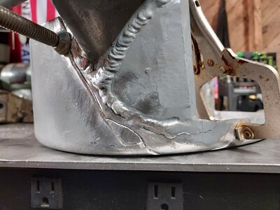

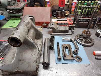

Had to fix the gear cover... it was broke and repaired previously. The last repair they didn't line-up the holes properly so I accidentally broken it. Now they line up. Lol

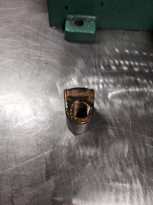

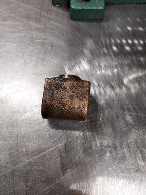

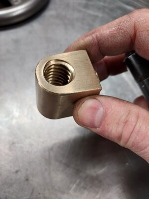

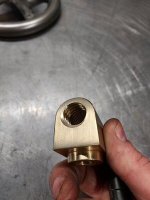

The cross-slide has .033" backlash. Instead of spending $75+ for a cross-slide nut, I cheaped out and machined my own. I had to order a tap... LH 11/16" - 8tpi acme tap... China came through. This tap is probably the best acme tap I have used in the past 20+ years... I was concerned about the quality, the geometry as well as the cutting edges being poor. Well, this tap was a pleasant change of pace. Tomorrow I'll be installing the nut.

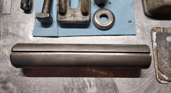

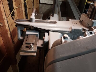

I still have to work on the Taper attachment clamp as well as the tailstock... the tailstock has been basterdized... so if I can't find a new ram/quill I'll have to machine one and use the cnc to engrave the graduations.

Nice work! I made a tail stock ram for my Clausing a long time ago. Used a small center drill in the Bridgeport with DRO, pecked the surface for the graduations, use small stamps for the numbers. Also needed a left hand acme tap for that too!

Thanks man. I have a piece of pre hardened 4140 that's 2" dia x 24". It's looking like I'll be machining a new ram as well. I'll use the CNC Mill and make a pocket so I can stick a graduated metal strip in... I think that'll look good.
I've been meaning to machine a new nut for my lathe as well. I have the 3/4-8 LH tap but I just need the time. I'd deal with 0.033" as I have about a 1/2 turn of backlash which would be 0.125". If you are used to it, it's not a big deal. It can get you when threading... did that take almost 2 or 3 turns to get out of the part? :thinking:
I've backed away from the saws to make more time for my personal things/projects. I still dont have much time as i always seem to to add irons to the fire.
I've dealt with lathes that had a bunch of backlash... like you said, once you get used to it, taking out the BL becomes 2nd nature. I always use dials during threading operations, especially with lathes that have excessive amounts of backlash. Cutting gears and threads I'm a bit particular with...
To be honest, I wasn't paying attention to how many turns it took... I just fed it through the part in amazement at how good the tap was cutting through the aluminum bronze.

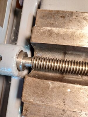

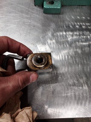

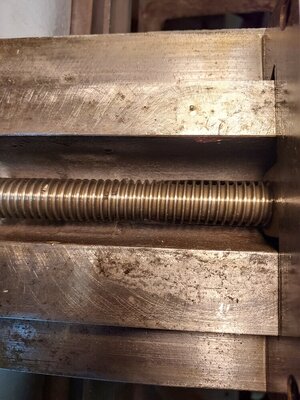

Old nut out, new nut in... backlash is better, down to .013"... the issue now is a worn shaft. Snapped a pic of the center of the screw as well as the end... you'll see the thread thickness difference. I can deal with
.013" but, it's not right... so, it's bothering me.

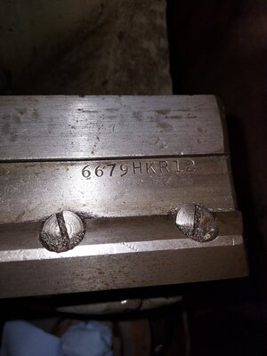

I'm sure they did as you can find them all over the world.... for this model, my lathe was # 6679 off of the assembly line.

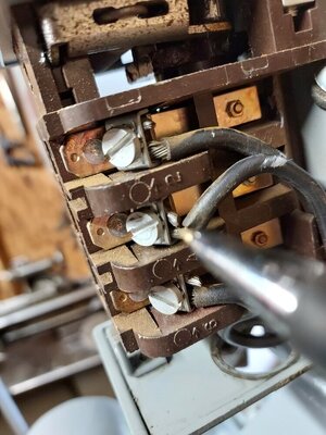

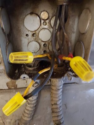

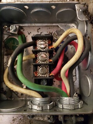

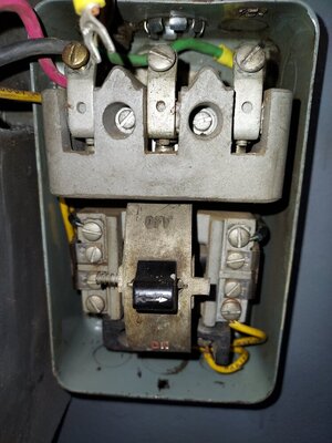

We have 120v x 2 legs into the converter, 120v x 3 legs out, we have 120v per leg to the switch, blue and red are hot, the middle black wire opposite side is hot... lathe will run for approximately 10 seconds and then trip.
We checked for continuity, ground and shorts... all checked out fine.
I'm going to pull apart the switch and clean it... try it again and if it repeats, I'll have to assume the breaker is bad.... idk crap about electricity.

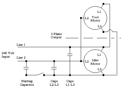

A rotary converter is basically a three phase motor with a start circuit .It uses a large capacitor across one winding to create a start circuit similar to a single phase motor and at speed uses a running cap which should be 7.5 microfared per HP . .The running cap balances the induction in the windings so they are about the same voltage .In this case 240 volts . From what you said sounds to me it's single phasing for some reason .
Al Smith
9:00 AM
537
Jan 14, 2016
6,132
13,533
North western Ohio
Note on that start switch it's a momentary contact ,only used to start the rotation .
