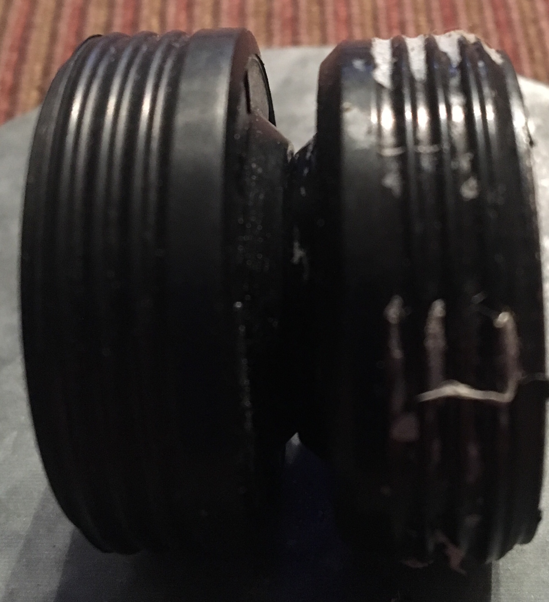

So I have a 141 with a bad crank seal. Ordered aftermarket bearing seal combo on evilbay install and they won't pass vac. test.
These seals have a chamfered edge where they are leaking. Are all aftermarket ones like this? Seller refunded sale so that was good. But I still need the seals.

Yes I tried moto seal. There's very little edge on the cylinder to seal to the bearing seal. The factory seal has a 90 degree angle at the edge and the aftermarket seal is at a 45 degree angle so where it is supposed to make contact on the cylinder there's no material to push against the bottom of the cylinder. That is where it's leaking.

I ordered OEM bearings/seals so hopefully that will be the ticket. Normally I go with OEM but the one time I don't I get burned

The new OEM bearing seal showed up today. The angled seal bearing was aftermarket.
Hopefully this weekend I'll have this saw gone as I'm quite sure the leak will be solved now
