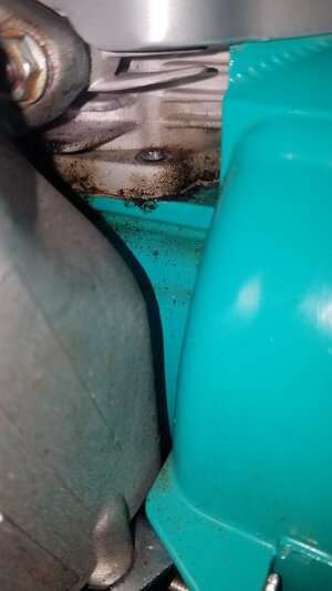

Its been a total beast, but it just snapped off a head bolt , which I caught almost immediately.
So I ordered a gasket set and I've got some good quality head bolts. I didn't have a gasket in there before, but im gonna add one . It really challenges me for starting and I think the gasket will help just a little bit.
