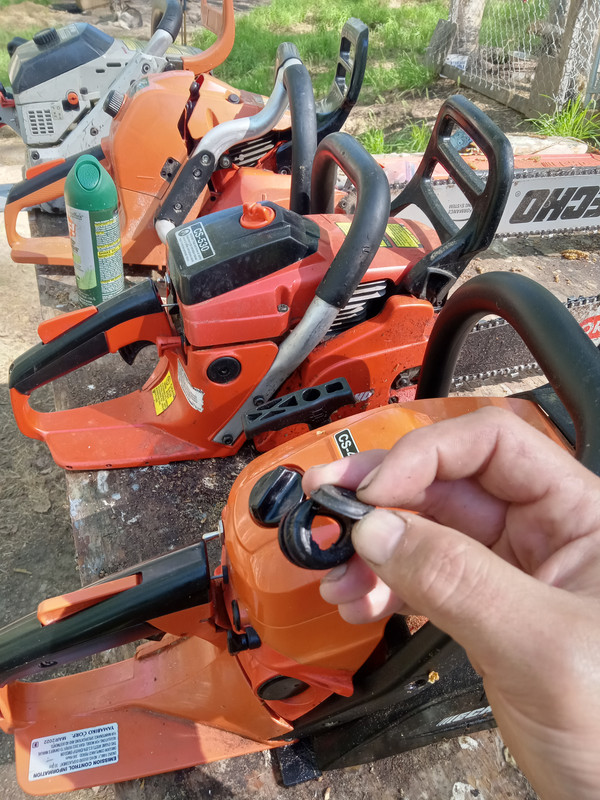

Bryanr2,
Glad you're doing better. I run a 4910 for clear cutting. Nice, nimble limbing saw. Even muffler modded, it won't have the power of your old echo cs 520 and won't be as tough as the cs 520/530 or your old 261. Many components are extremely thin on the 4910/501p to make it that light weight:
Paper thin/hollowed av bushings, they tear easily
Tin can muffler dents easy
Plastics half as thick as the plastics of your cs 520
Clutch cover extremely flimsy.
The plastics fade purdy quick compared to older kioritz plastic.
GREAT warranty. Echo just sent me a 5 pack of av bushings, to replace them myself if I ever have another one go bad. Just one call, and they send me parts free of charge.
I run a versacut aluminum core bar and lgx chain on mine, affordable set-up.
