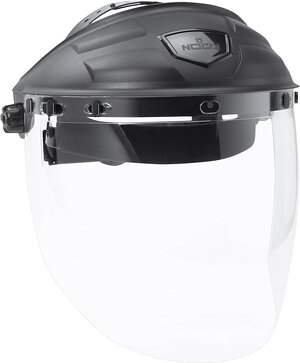

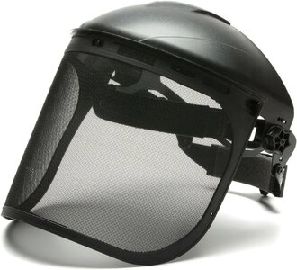

They're supposed to be real good at protecting you while using a chainsaw, but I'd be using while using my string trimmer.
The wire mesh seems like it would resist fogging up in the cold weather brilliantly.
I currently use a NoCry clear plastic face shield and let me tell you, it has saved my face and eyes many times over.
Here's the question : For you guys that have used the wire mesh visors, how well can you see out of them clarity wise?

I use my chainsaw helmet with mesh shield while trimming. You can see well with it except when the sun is in your face.

When I weedeat I wear an old Stihl ear muff/mesh shield set, and just bought a similar setup from Bailey's for my grandson. I can see through it very well, unless the sun hits at just the right angle, then there's a "glare" on the mesh.
I wear large-lense prescription glasses with polycarbonate lenses all the time; if I did not I would wear safety glasses with the shield, at least while weedeating. I don't use the mesh shield while mowing or cutting wood, but I'd not be without glasses of some type while doing either.

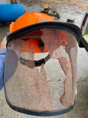

The wire mesh works great; visibility is fine. My problem is the durability. I sweat profusely. The wire mesh can rust away after a few uses, so it is not an option for me; at least not an affordable option.

I sweat a lot too but I haven't noticed any rusting. Mine might be plastic, I'll have to look.
If you have a plastic one, let me know because I want one. I like the face shield; they work. I did not take a picture but I had a big splinter fly under my safety glasses (while running trimmer/weed eater) and stick me right below the eye (was not wearing face shield). I was shocked that it got behind the glasses and that close to my eye.

I’ve had that same problem, although not to that extent. I hit mine occasionally with flat black (to reduce glare) Rustoleum occasionally, brushing with a soft bristle stainless wire brush to remove buildup from the last coat. It wouldn’t take much to start filling up the screen, so I use quick light passes.

I was thinking maybe some of them might be a plastic mesh like they have in some oil filters.
