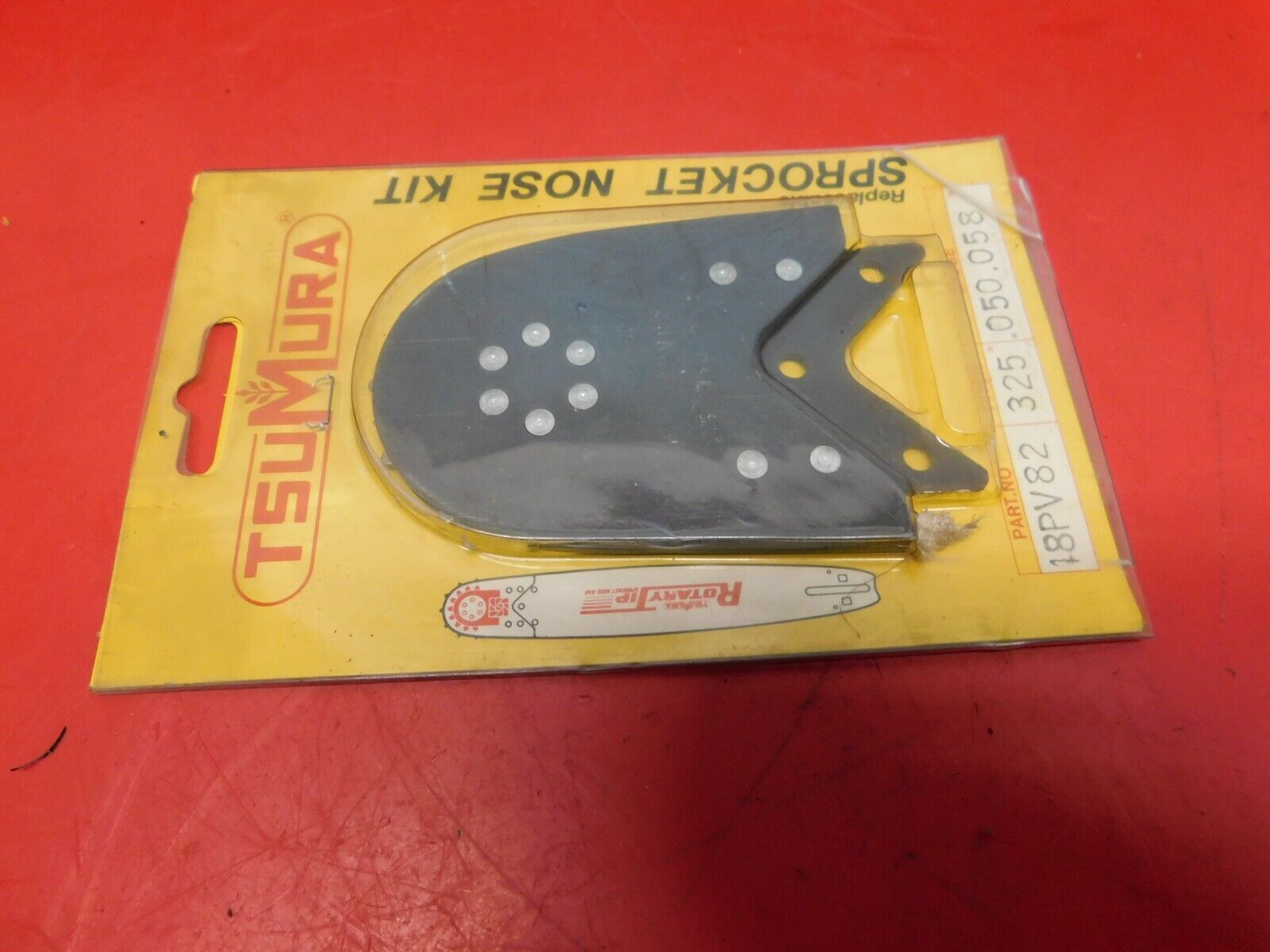

I have a couple of Jonsered/Tsumura bars I'd like to change from 3/8 to .325 and I can't figure out the correct part number. I ordered one and it was to small. The pic is of the tips that are on the bar now. Thanks for any help.

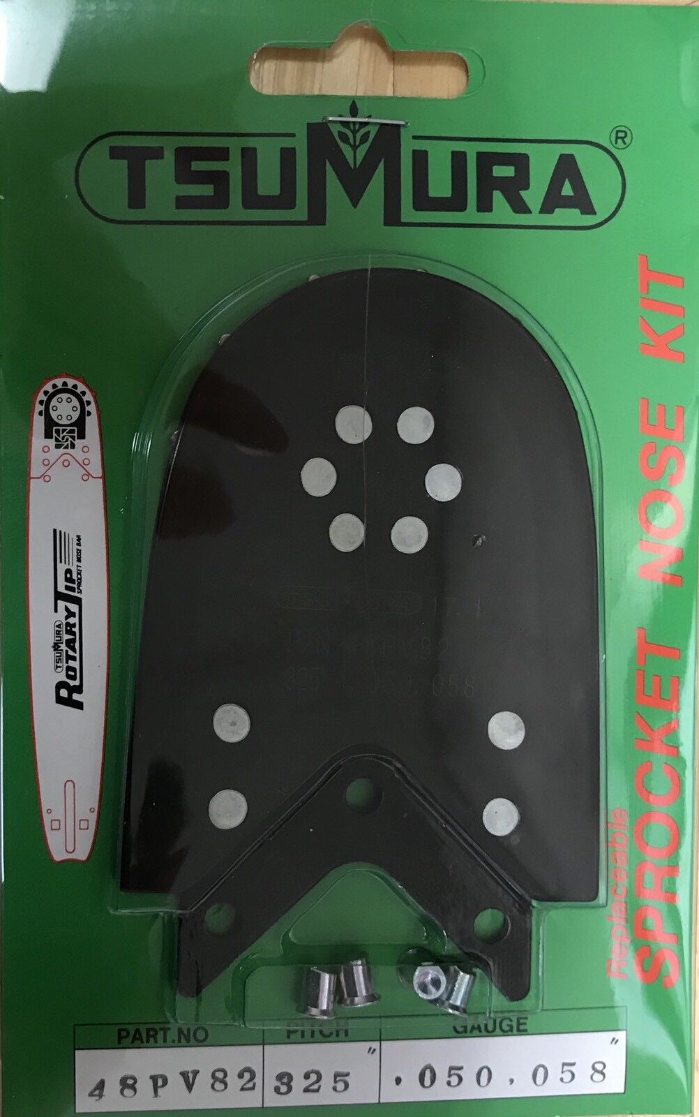

Is this the correct one?

Same part number that has to tell you something
I saw that and want to be sure because even though they have the same part number, one is 3/8 and the other is .325.

But don’t they both say .325 in the pics of tips in packets , although the tip on the bar in your first pic does say 3/8
so I will say both are wrong in the packages.

I contacted Archerplus through ebay and they said that the one in the green packaging would fit and updated their listing to reflect that. Updated description on ebay,
This is a new TsuMura professional .325 pitch .050-.058 gauge, replaceable sprocket nose assembly that fits TsuMura and TOTAL SUPER bars that are .050 or .058 gauge guide bars and are "FV" "FK" type guide bars, you can tell if your guide bar is a "FV" or "FK" type bar because these letters will be part of the part numbers listed on the tail end of your guide bar.

I do, when I replyed to you I thought that one of the new bar tips had the same part number as the 3/8 tip does but it says PV and the one on the bar says FV. I got it straight now.
