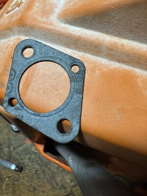

Waleska,Ga.
Well, seems that claiming to know something inside and out doesn’t prevent you from making mistakes. Found this right away. Hopefully it will fix the saw. Wife just got up so I’m out the door to find out. IMG_5994.jpeg

Waleska,Ga.
That fixed it. Saw runs awesome again.
