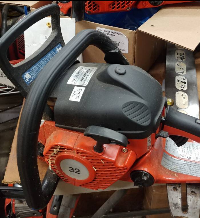

Some saws can take a fair few pulls to fire up from sitting unused , some not, so if the saw runs well once you tune the carb I wouldn't be concerned.
Dolmar Ps-32 /Makita Ea-3200 are the same saw just colour different.
I use a Ps-32 myself for smaller jobs , very decent cheep saw in my opinion. There 4 spring anti vibe, SS exhaust, adjustable bar oiler, easy start recoil ..purge bulb and MPI coil. They have a Hex port cylinder and run stronger than there 32 cc would suggest. If you remove the Cat in the exhaust this adds to the throttle response as well as giving a little extra power . You can get the saw with bar nuts rather than the hand quick tension cover( works well and not any trouble)...slimmer profile with the nuts .
View attachment 186521 View attachment 186522 View attachment 186523 View attachment 186524
The PS-32 / EA3200 / EA3201 is a very good little saw for the size and money.
A little modification could make it a little lighter and give it a bit more power.
