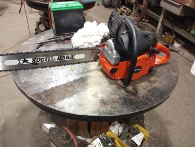

Need help identifying this Dolmar, west germ. I’ve had people say it’s a ca but my uncle a huge avid Dolmar man does not believe it is there’s a side vent he states is different, along with other small details please let me know if I can answer any questions.

It’s a CA. Just like this one, except mine has AV’s. View attachment 485698
Yours looks like it could have the rear AV’s, just not the top handle.
The olden days when they had round curves instead of boxy corners. 🥰
