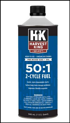

I would recommend getting a quart of premixed fuel, run that and see if there is any difference, if so, then yes, the fuel you use will matter, if no then there is another issue with the blower. I mix my own gas during the heavy use season and for those tools going on the shelf, I will drain the fuel I mixed and run some of this through and let it sit the winter (or until next time I use it).
