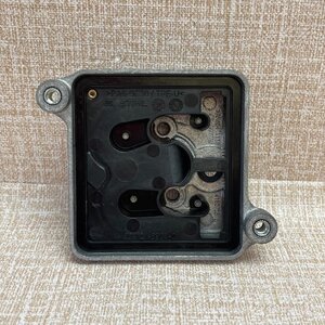

If I start up the trimmer and bring to full throttle to warm it up and then shut it down, about 30 seconds after shut down, fuel will burp out of the brass vent port in the air filter housing and then run along the bottom of the black plastic recess where the air filter seal makes contact. That's the little brass hole you see at the top left of the air filter housing in the eBay picture I copied. Is this normal behavior?

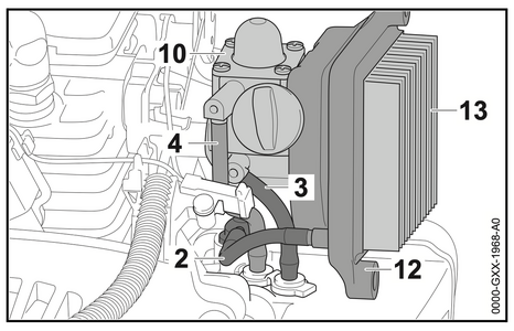

When replacing the tank vent for the 2nd time, I decided to replace all three fuel hoses too.
The #4 fuel hose coming from the tank to the primer bulb was split wide open at the base of the hose where it connects to the tank.
The other hoses were fine other than the usual hardened rubber.
I don't think anything was ever wrong with the vents during this case. I think it had something to do with the #4 hose.
