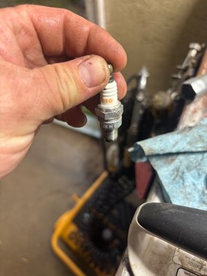

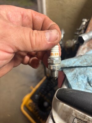

Not all the NGK plugs are Made in Japan. There’s some interesting stuff about the plugs from Stihl and husky. The brand new out of the box Stihl saw have BPMR7A plugs that the steel head only stamped JAPAN on it. Husky’s have both NGK and JAPAN on it. And I have noticed such thing for some time. And I once bought a few NGK that have different stamping on the head and the box said made in Mexico. I would only use green letter Bosch cuz they are German or Brazil made but some are from India. Blue letter Bosch plugs always stamped China. New Champion? Meh. Old Champion stamped USA? Hell yeah.
