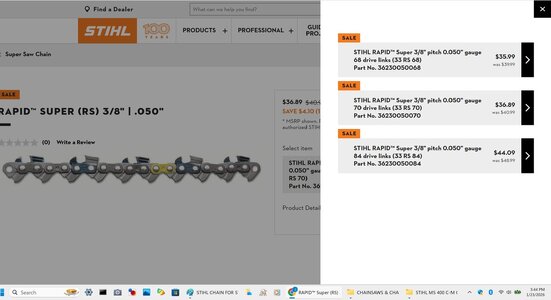

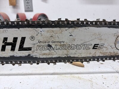

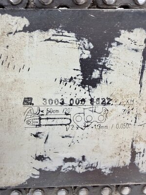

I have a Stihl MS 400 that I use in maintaining my property. I'm still on the original chain but want to buy a couple of spares. I have the 20" Rollomatic ES bar, part number 3003 000 8822. I have a yellow, full chisel, 72 tooth chain on it. I believe the part number is 3623 005 0072. When I search online, indeed that is a chain that exists or existed. See the attached photo. But when I go to the Stihl website, that part number does not exist. 3623 005 0068 exists, 3623 005 0070 exists, 3623 005 0084 exists, but 3623 005 0072 does NOT exist. See the screenshot photo. Does the 70 tooth chain replace the 72 tooth chain? I just don't understand. The markings on the bar also show that a 72 tooth chain needs to be used. See the attached photo. Can somebody explain? Is Stihl not making a yellow, full chisel, 72 tooth chain anymore? Thanks.

The first picture you shared is .325 chain. You need 3/8.
I wouldn’t worry about the part number. Walk into any dealer like mentioned and get 3/8 x .050 72 DL in either chisel or semi chisel and you will be in business

Thank you. I’m actually reasonably competent and pretty quick at sharpening and know how to keep it out of the dirt, so I would like to stay with a full chisel if possible and I looked at the photo again and it does say 3/8, so I believe that chain is the correct part number. From what the other guys have said, it sounds like the chain is readily available. I couldn’t find the 72 link version on the Stihl website and was thinking maybe they weren’t making it anymore but I guess they just have it missing from the website for some reason.

Pretty common to change part numbers to reflect "new" price point. We all know which way that goes...
The answer to this is no, you will always use a 72 drive link chain with that bar, no matter what type of 3/8 .050 chain you are using (Husqvarna, Oregon, Duke's, full chisel (Super - S), semi (Micro-M), Duro....etc.
